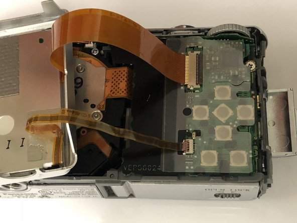

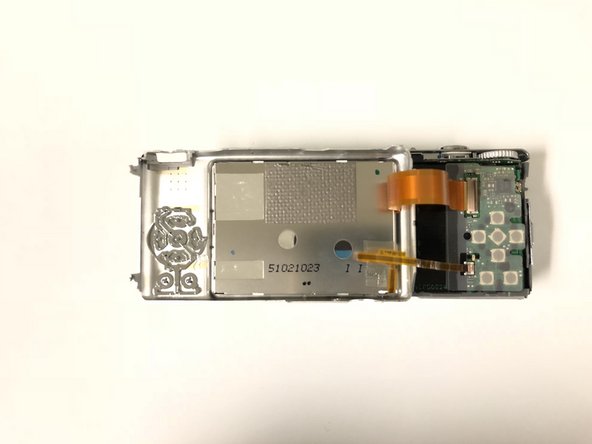

    • Pry the top part of the camera slowly. Be careful not to tear the digitizer cable.
  5. Panasonic Lumix DMC-FX9 Loose Digitizer Cable Replacement: crwdns2935265:05crwdnd2935265:01crwdnd2935265:02crwdne2935265:0 Panasonic Lumix DMC-FX9 Loose Digitizer Cable Replacement: crwdns2935265:05crwdnd2935265:02crwdnd2935265:02crwdne2935265:0

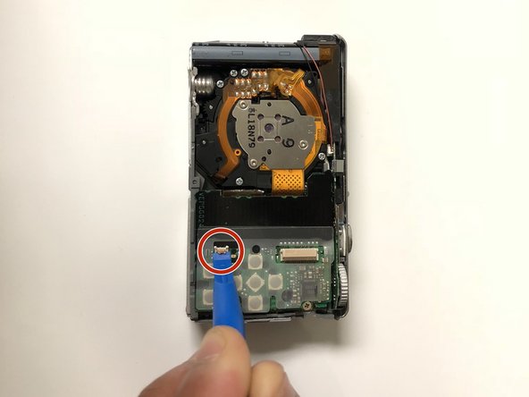

    • Open the bigger clamp using a spudger or other tools. Repeat for the smaller clamp.
  6. Panasonic Lumix DMC-FX9 Loose Digitizer Cable Replacement: crwdns2935265:06crwdnd2935265:01crwdnd2935265:02crwdne2935265:0 Panasonic Lumix DMC-FX9 Loose Digitizer Cable Replacement: crwdns2935265:06crwdnd2935265:02crwdnd2935265:02crwdne2935265:0

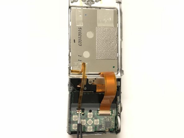

    • Carefully take the thin ribbon and insert cable end into the latch. Do this for both sides.
  7. Panasonic Lumix DMC-FX9 Loose Digitizer Cable Replacement: crwdns2935265:07crwdnd2935265:01crwdnd2935265:03crwdne2935265:0 Panasonic Lumix DMC-FX9 Loose Digitizer Cable Replacement: crwdns2935265:07crwdnd2935265:02crwdnd2935265:03crwdne2935265:0 Panasonic Lumix DMC-FX9 Loose Digitizer Cable Replacement: crwdns2935265:07crwdnd2935265:03crwdnd2935265:03crwdne2935265:0
    • Once the ribbon is placed into the latch, carefully close the clamps by lowering the clamp into a down position. Repeat this step for both sides.
