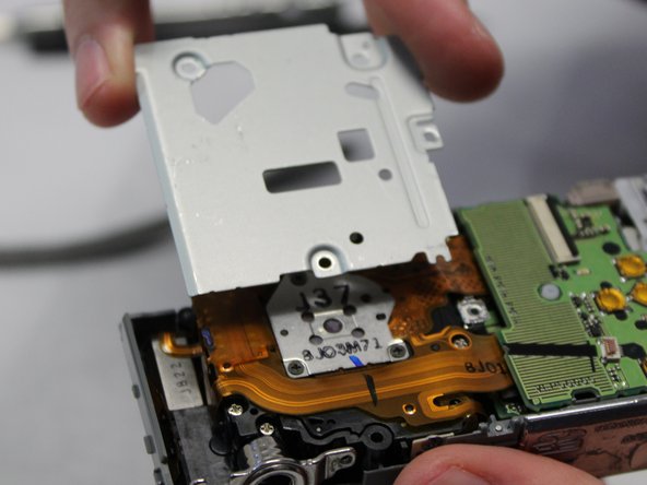

  6. Panasonic Lumix DMC-FX37 Photoreceptor Replacement, Photoreceptor: crwdns2935265:06crwdnd2935265:01crwdnd2935265:02crwdne2935265:0 Panasonic Lumix DMC-FX37 Photoreceptor Replacement, Photoreceptor: crwdns2935265:06crwdnd2935265:02crwdnd2935265:02crwdne2935265:0
    • Locate and remove the silver 2mm screw on the protection panel.
    • Remove the three black 8mm screws that remain.
    • Be sure to remember which length of screw goes to which slot. Failing to do so could damage your device.
    • Proceed to remove the protection panel entirely.

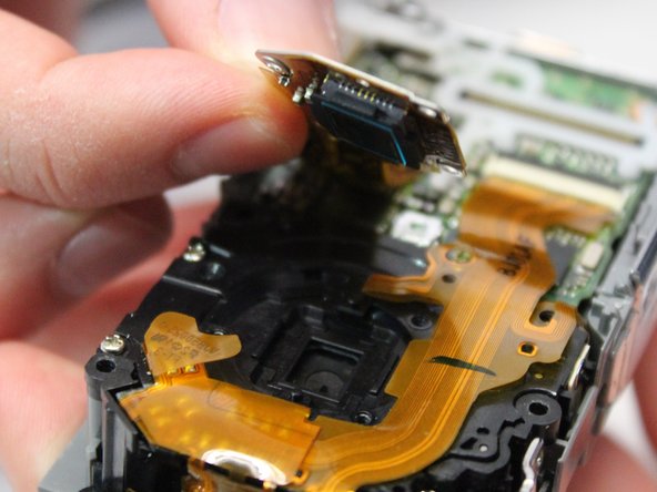

  8. Panasonic Lumix DMC-FX37 Photoreceptor Replacement: crwdns2935265:08crwdnd2935265:01crwdnd2935265:01crwdne2935265:0
    • Use the pointed end of the spudger to lift the black tabs holding the ribbon cable connected to the photoreceptor in place.
    • Before pulling the cable free, be sure to complete the next step (removing the screws) as the ribbon cables are delicate and must be handled with care.
  9. Panasonic Lumix DMC-FX37 Photoreceptor Replacement: crwdns2935265:09crwdnd2935265:01crwdnd2935265:02crwdne2935265:0 Panasonic Lumix DMC-FX37 Photoreceptor Replacement: crwdns2935265:09crwdnd2935265:02crwdnd2935265:02crwdne2935265:0
    • Remove the three 3mm screws holding the photoreceptor in place.
    • Carefully lift the photoreceptor, disconnecting the ribbon cable and remove the photoreceptor from the device.
