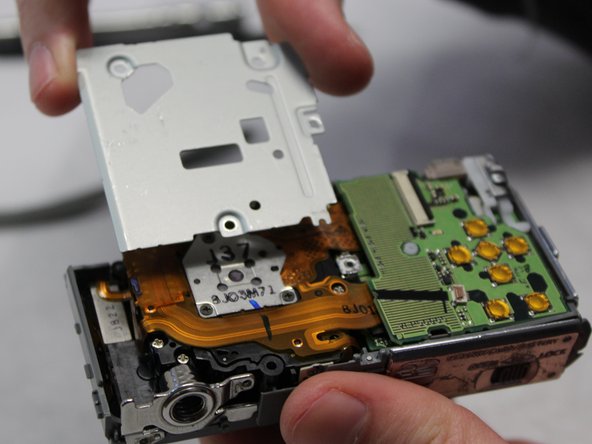

  6. Panasonic Lumix DMC-FX37 Lens Casing Replacement, Lens Casing: crwdns2935265:06crwdnd2935265:01crwdnd2935265:02crwdne2935265:0 Panasonic Lumix DMC-FX37 Lens Casing Replacement, Lens Casing: crwdns2935265:06crwdnd2935265:02crwdnd2935265:02crwdne2935265:0
    • Unscrew the silver 2mm screw from the protection panel.
    • Unscrew the three black 8mm screws from the protection panel.
    • Be sure to remember where these screws go, inserting a longer screw in a short slot can damage your device!
    • Remove the protection panel entirely.

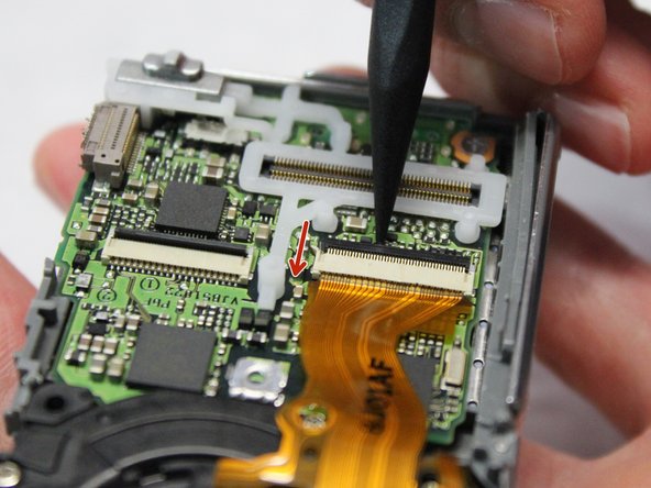

  7. Panasonic Lumix DMC-FX37 Lens Casing Replacement: crwdns2935265:07crwdnd2935265:01crwdnd2935265:01crwdne2935265:0
    • Insert the flat end of a spudger underneath the motherboard and twist. This will disconnect it from the rest of the device.
  8. Panasonic Lumix DMC-FX37 Lens Casing Replacement: crwdns2935265:08crwdnd2935265:01crwdnd2935265:02crwdne2935265:0 Panasonic Lumix DMC-FX37 Lens Casing Replacement: crwdns2935265:08crwdnd2935265:02crwdnd2935265:02crwdne2935265:0
    • Using the pointed end of a spudger, flip up the two black tabs holding the ribbon cables in place.

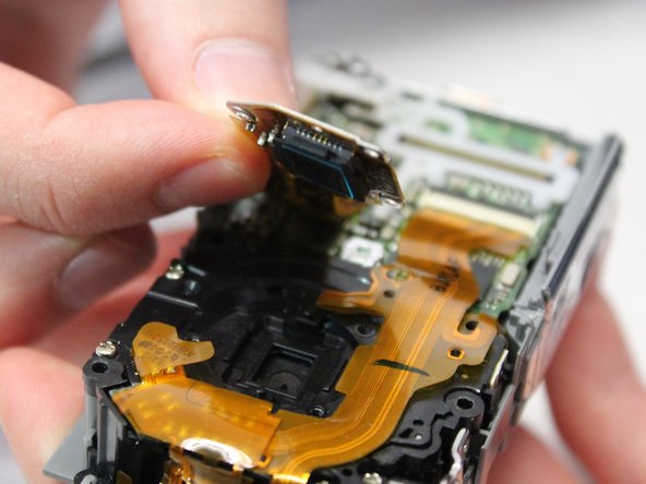

  9. Panasonic Lumix DMC-FX37 Lens Casing Replacement: crwdns2935265:09crwdnd2935265:01crwdnd2935265:02crwdne2935265:0 Panasonic Lumix DMC-FX37 Lens Casing Replacement: crwdns2935265:09crwdnd2935265:02crwdnd2935265:02crwdne2935265:0
    • Unscrew the three 3mm screws holding the photoreceptor in place.
    • Lift the photoreceptor and gently pull it to release the now disconnected ribbon cable.
  10. Panasonic Lumix DMC-FX37 Lens Casing Replacement: crwdns2935265:010crwdnd2935265:01crwdnd2935265:01crwdne2935265:0
    • Gently lift and remove the lens casing, pulling it free from the now disconnected ribbon cable.
