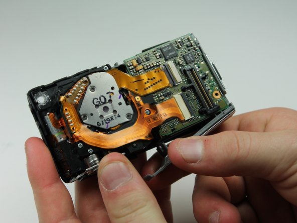

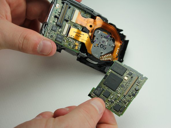

  9. Panasonic Lumix DMC-FX07 USB Port Replacement, Motherboard: crwdns2935265:09crwdnd2935265:01crwdnd2935265:01crwdne2935265:0
    • Remove the small screw in the hole towards the top of the camera(#00P, 5.4mm).
  10. Panasonic Lumix DMC-FX07 USB Port Replacement: crwdns2935265:010crwdnd2935265:01crwdnd2935265:02crwdne2935265:0 Panasonic Lumix DMC-FX07 USB Port Replacement: crwdns2935265:010crwdnd2935265:02crwdnd2935265:02crwdne2935265:0
    • Use the spudger to lift up the back logic board.
    • Using your fingers, gently wiggle and pull off the back motherboard.
    • You will hear a click when you lift it up.

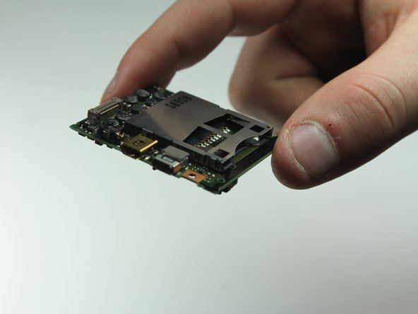

  11. Panasonic Lumix DMC-FX07 USB Port Replacement: crwdns2935265:011crwdnd2935265:01crwdnd2935265:01crwdne2935265:0
    • Remove the small screw holding down the lower motherboard(#00P, 3.2mm).
  12. Panasonic Lumix DMC-FX07 USB Port Replacement: crwdns2935265:012crwdnd2935265:01crwdnd2935265:03crwdne2935265:0 Panasonic Lumix DMC-FX07 USB Port Replacement: crwdns2935265:012crwdnd2935265:02crwdnd2935265:03crwdne2935265:0 Panasonic Lumix DMC-FX07 USB Port Replacement: crwdns2935265:012crwdnd2935265:03crwdnd2935265:03crwdne2935265:0

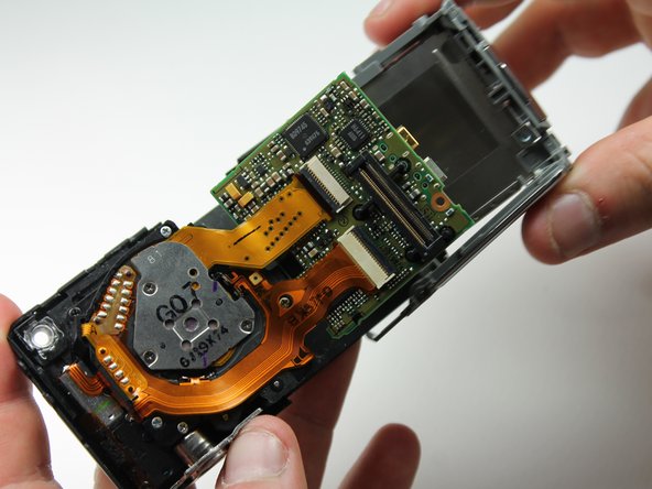

    • Use the spudger to lift the upper tab from the main housing.
    • Gently lift the lower tab from the main body by prying it with your finger.
    • Gently pull off the plastic motherboard housing sideways.

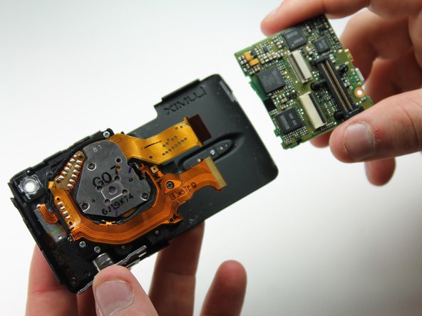

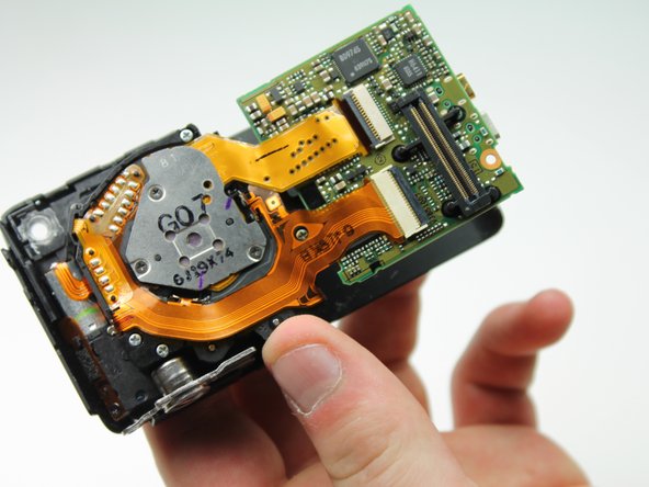

  13. Panasonic Lumix DMC-FX07 USB Port Replacement: crwdns2935265:013crwdnd2935265:01crwdnd2935265:03crwdne2935265:0 Panasonic Lumix DMC-FX07 USB Port Replacement: crwdns2935265:013crwdnd2935265:02crwdnd2935265:03crwdne2935265:0 Panasonic Lumix DMC-FX07 USB Port Replacement: crwdns2935265:013crwdnd2935265:03crwdnd2935265:03crwdne2935265:0
    • Gently lift the tabs on the ZIF connectors connecting the lens to the front motherboard.
    • Once you lift the tabs the ribbons should fall right out and the front motherboard should be free.
  14. Panasonic Lumix DMC-FX07 USB Port Replacement, USB Port: crwdns2935265:014crwdnd2935265:01crwdnd2935265:02crwdne2935265:0 Panasonic Lumix DMC-FX07 USB Port Replacement, USB Port: crwdns2935265:014crwdnd2935265:02crwdnd2935265:02crwdne2935265:0
    • The USB port is hardwired into this motherboard.
