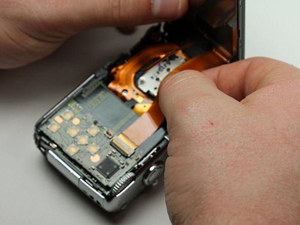

    • Lift up the bottom back cover by prying the bottom edge with the spudger.
    • Gently lift up the back cover with your hand from the bottom to the top.
  7. Panasonic Lumix DMC-FX07 LCD Display Replacement: crwdns2935265:07crwdnd2935265:01crwdnd2935265:03crwdne2935265:0 Panasonic Lumix DMC-FX07 LCD Display Replacement: crwdns2935265:07crwdnd2935265:02crwdnd2935265:03crwdne2935265:0 Panasonic Lumix DMC-FX07 LCD Display Replacement: crwdns2935265:07crwdnd2935265:03crwdnd2935265:03crwdne2935265:0
    • Lift the tabs on the ZIF connectors.
    • The ribbon cables should easily come out of the ZIF connectors.
  8. Panasonic Lumix DMC-FX07 LCD Display Replacement, LCD Display: crwdns2935265:08crwdnd2935265:01crwdnd2935265:03crwdne2935265:0 Panasonic Lumix DMC-FX07 LCD Display Replacement, LCD Display: crwdns2935265:08crwdnd2935265:02crwdnd2935265:03crwdne2935265:0 Panasonic Lumix DMC-FX07 LCD Display Replacement, LCD Display: crwdns2935265:08crwdnd2935265:03crwdnd2935265:03crwdne2935265:0
    • Use the pointed end of the spudger to pry off the LCD screen from the back cover. Place the tip of the spudger in the small hole in the bracket on the LCD screen and lift it out.
