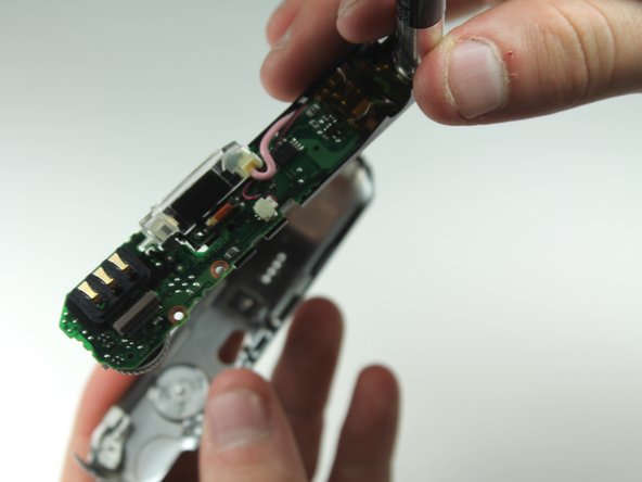

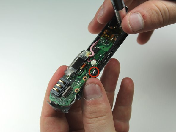

  9. Panasonic Lumix DMC-FX07 Flash Assembly Replacement, Flash Assembly: crwdns2935265:09crwdnd2935265:01crwdnd2935265:01crwdne2935265:0
    • Unscrew the small screws beneath the top cover(#00P, 1.7mm).
  10. Panasonic Lumix DMC-FX07 Flash Assembly Replacement: crwdns2935265:010crwdnd2935265:01crwdnd2935265:03crwdne2935265:0 Panasonic Lumix DMC-FX07 Flash Assembly Replacement: crwdns2935265:010crwdnd2935265:02crwdnd2935265:03crwdne2935265:0 Panasonic Lumix DMC-FX07 Flash Assembly Replacement: crwdns2935265:010crwdnd2935265:03crwdnd2935265:03crwdne2935265:0
    • Lift the logic board out with your hand by pushing the tabs out and pulling the logic board up.
    • The on/off switch and the anti-shake button may fall out.
  11. Panasonic Lumix DMC-FX07 Flash Assembly Replacement: crwdns2935265:011crwdnd2935265:01crwdnd2935265:01crwdne2935265:0
    • The flash assembly is hardwired into the top circuit board.
