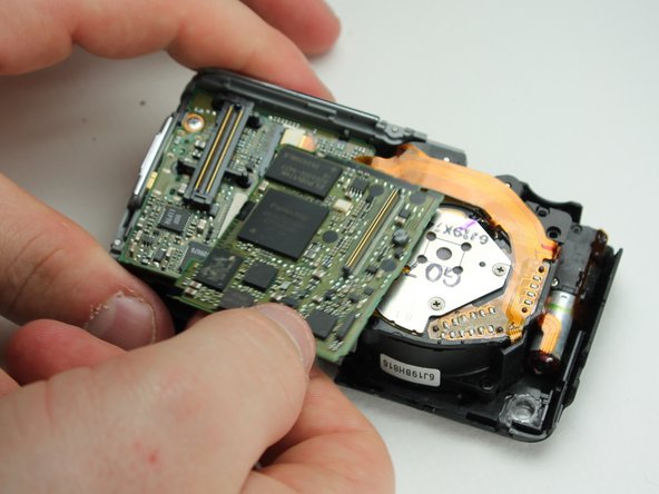

  8. Panasonic Lumix DMC-FX07 Back Panel Buttons Replacement, Back Panel Buttons: crwdns2935265:08crwdnd2935265:01crwdnd2935265:02crwdne2935265:0 Panasonic Lumix DMC-FX07 Back Panel Buttons Replacement, Back Panel Buttons: crwdns2935265:08crwdnd2935265:02crwdnd2935265:02crwdne2935265:0
    • Gently wiggle out the top motherboard.
    • The buttons are hardwired into this logic board.
