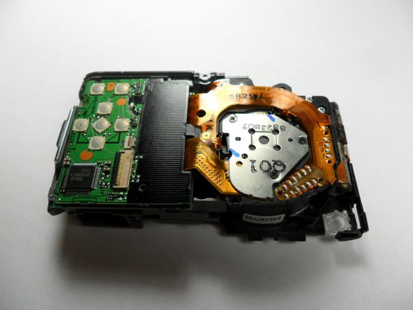

  9. Panasonic Lumix DMC-FX01 Flash Top Assembly Replacement: crwdns2935265:09crwdnd2935265:01crwdnd2935265:02crwdne2935265:0 Panasonic Lumix DMC-FX01 Flash Top Assembly Replacement: crwdns2935265:09crwdnd2935265:02crwdnd2935265:02crwdne2935265:0
    • Gently remove the back casing.
    • Start at the bottom and carefully pry towards the top to get this piece free.
  10. Panasonic Lumix DMC-FX01 Flash Top Assembly Replacement, Flash Top Assembly: crwdns2935265:010crwdnd2935265:01crwdnd2935265:02crwdne2935265:0 Panasonic Lumix DMC-FX01 Flash Top Assembly Replacement, Flash Top Assembly: crwdns2935265:010crwdnd2935265:02crwdnd2935265:02crwdne2935265:0
    • Carefully pry the Flash Top Assembly away from the top.
  11. Panasonic Lumix DMC-FX01 Flash Top Assembly Replacement: crwdns2935265:011crwdnd2935265:01crwdnd2935265:02crwdne2935265:0 Panasonic Lumix DMC-FX01 Flash Top Assembly Replacement: crwdns2935265:011crwdnd2935265:02crwdnd2935265:02crwdne2935265:0
    • Replace the Flash Top Assembly with a new one.
