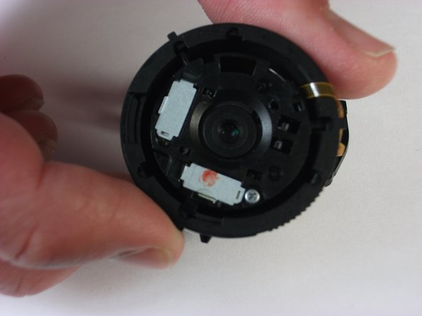

  18. Panasonic Lumix DMC-FX01 Camera Lens Replacement, Camera Lens: crwdns2935265:018crwdnd2935265:01crwdnd2935265:01crwdne2935265:0
    • Remove four 4 mm screws from the lens assembly using the Phillips #00 screwdriver.
  19. Panasonic Lumix DMC-FX01 Camera Lens Replacement: crwdns2935265:019crwdnd2935265:01crwdnd2935265:02crwdne2935265:0 Panasonic Lumix DMC-FX01 Camera Lens Replacement: crwdns2935265:019crwdnd2935265:02crwdnd2935265:02crwdne2935265:0
    • Separate the fixed frame unit from the main lens assembly.
    • Separate the direct frame unit from the main lens assembly.
  20. Panasonic Lumix DMC-FX01 Camera Lens Replacement: crwdns2935265:020crwdnd2935265:01crwdnd2935265:01crwdne2935265:0
    • Remove the first lens frame from the lens assembly.
  21. Panasonic Lumix DMC-FX01 Camera Lens Replacement: crwdns2935265:021crwdnd2935265:01crwdnd2935265:01crwdne2935265:0
    • Detach the second frame unit from the lens assembly.
  22. Panasonic Lumix DMC-FX01 Camera Lens Replacement: crwdns2935265:022crwdnd2935265:01crwdnd2935265:01crwdne2935265:0
    • Remove the 4m m screw from the lens housing using the Phillips #00 screwdriver.
  23. Panasonic Lumix DMC-FX01 Camera Lens Replacement: crwdns2935265:023crwdnd2935265:01crwdnd2935265:01crwdne2935265:0
    • Separate the lens housing.
    • Replace the lens by gently prying away from the assembly.
