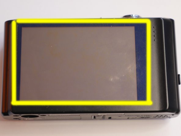

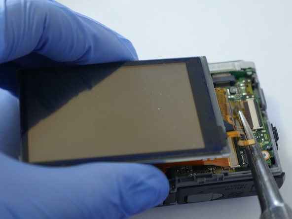

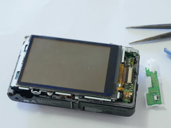

  6. Panasonic Lumix DMC-FH27 Main Board PCB Replacement, Step 6: crwdns2935265:06crwdnd2935265:01crwdnd2935265:02crwdne2935265:0 Panasonic Lumix DMC-FH27 Main Board PCB Replacement, Step 6: crwdns2935265:06crwdnd2935265:02crwdnd2935265:02crwdne2935265:0
    • Do not remove the Rear Casing because it is attached via cable to the Main PCB and circuit board.
    • Pry the casing upward slightly, careful NOT to remove it. Only lift it slightly as shown in the picture.
    • The LCD is attached to the rear casing via a light coating of adhesive on the underside of the yellow highlighted area. In the next step you will apply light pressure to the LCD to release it from the case.

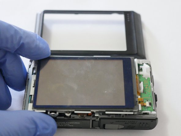

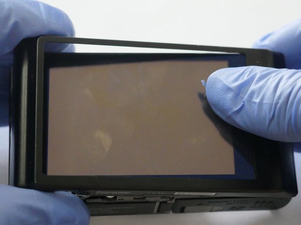

  7. Panasonic Lumix DMC-FH27 Main Board PCB Replacement, Step 7: crwdns2935265:07crwdnd2935265:01crwdnd2935265:03crwdne2935265:0 Panasonic Lumix DMC-FH27 Main Board PCB Replacement, Step 7: crwdns2935265:07crwdnd2935265:02crwdnd2935265:03crwdne2935265:0 Panasonic Lumix DMC-FH27 Main Board PCB Replacement, Step 7: crwdns2935265:07crwdnd2935265:03crwdnd2935265:03crwdne2935265:0
    • Do not apply heavy pressure and Do Not apply uneven pressure. If you find yourself applying too much pressure then dab some Isopropyl Alcohol 91% using a qtip along the edges to loosen the adhesive.
    • Using your thumbs gently apply pressure to release the LCD. Both thumbs should be applying even pressure and work your way down to the bottom.
    • Once LCD is free of casing, remove Rear Case.

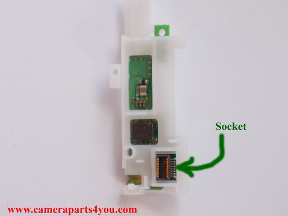

  9. Panasonic Lumix DMC-FH27 Main Board PCB Replacement, Step 9: crwdns2935265:09crwdnd2935265:01crwdnd2935265:03crwdne2935265:0 Panasonic Lumix DMC-FH27 Main Board PCB Replacement, Step 9: crwdns2935265:09crwdnd2935265:02crwdnd2935265:03crwdne2935265:0 Panasonic Lumix DMC-FH27 Main Board PCB Replacement, Step 9: crwdns2935265:09crwdnd2935265:03crwdnd2935265:03crwdne2935265:0
    • Use a Spudger or other tool to release the plastic hold down. Then pry the entire assembly upward releasing it from the socket. Try to keep the part as level as possible while prying up.
    • Remove the part
    • In the last picture you can see (on the reverse side of the part) the socket. This helps understand how the socket snaps down onto the Main Board.

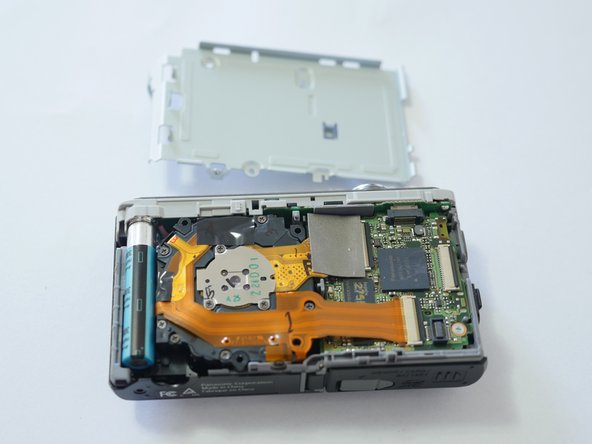

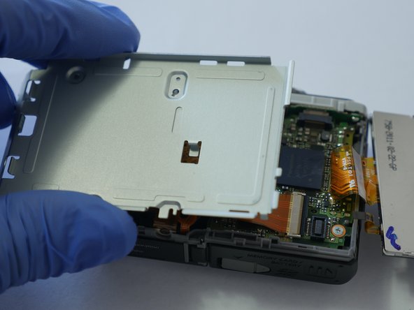

  10. Panasonic Lumix DMC-FH27 Main Board PCB Replacement, Step 10: crwdns2935265:010crwdnd2935265:01crwdnd2935265:03crwdne2935265:0 Panasonic Lumix DMC-FH27 Main Board PCB Replacement, Step 10: crwdns2935265:010crwdnd2935265:02crwdnd2935265:03crwdne2935265:0 Panasonic Lumix DMC-FH27 Main Board PCB Replacement, Step 10: crwdns2935265:010crwdnd2935265:03crwdnd2935265:03crwdne2935265:0
    • Remove 3 silver (0.8mm) screws from the rear metal plate.
    • Lift up and remove the metal plate
  11. Panasonic Lumix DMC-FH27 Main Board PCB Replacement, Step 11: crwdns2935265:011crwdnd2935265:01crwdnd2935265:03crwdne2935265:0 Panasonic Lumix DMC-FH27 Main Board PCB Replacement, Step 11: crwdns2935265:011crwdnd2935265:02crwdnd2935265:03crwdne2935265:0 Panasonic Lumix DMC-FH27 Main Board PCB Replacement, Step 11: crwdns2935265:011crwdnd2935265:03crwdnd2935265:03crwdne2935265:0

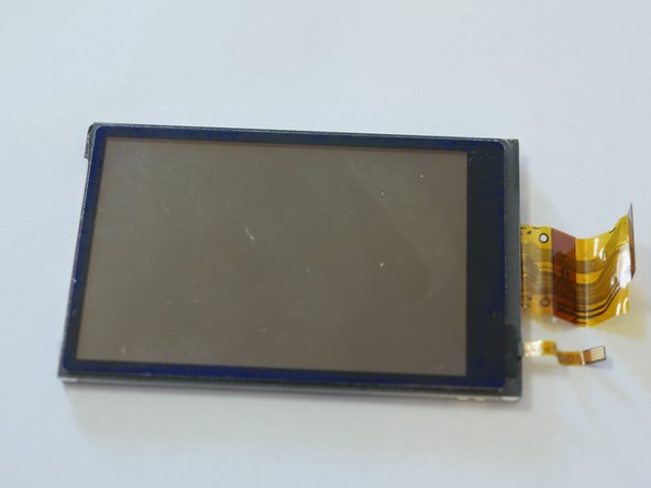

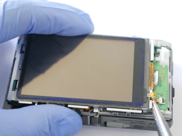

    • Use the spudger or other tool to flip up the LCD cable clamp.
    • Use Needle nose pliers or other tool to pull out the cable from the clamp.
    • Note: The metal protection plate has been removed so DO NOT let the LCD rest on the Rear of the camera. Do NOT touch any part of the rear camera or circuits with your bare hands. ESD can destroy your camera.
    • Remove the LCD part VYK4P64
    • When you purchase part make sure it has all three components included (backlite, touch screen and LCD display)

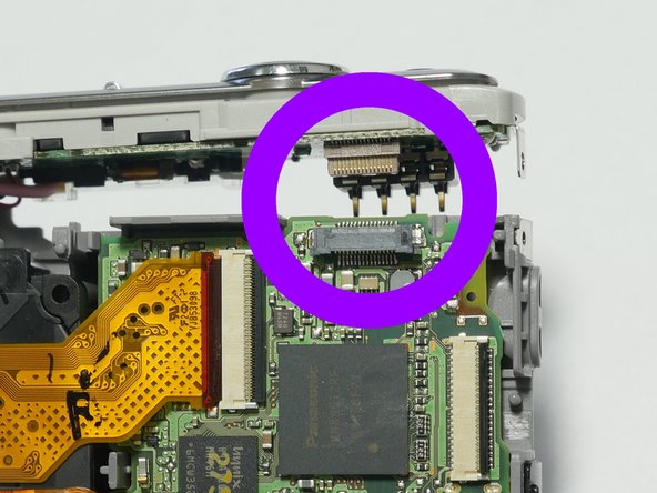

  14. Panasonic Lumix DMC-FH27 Main Board PCB Replacement, Step 3: crwdns2935265:014crwdnd2935265:01crwdnd2935265:03crwdne2935265:0 Panasonic Lumix DMC-FH27 Main Board PCB Replacement, Step 3: crwdns2935265:014crwdnd2935265:02crwdnd2935265:03crwdne2935265:0 Panasonic Lumix DMC-FH27 Main Board PCB Replacement, Step 3: crwdns2935265:014crwdnd2935265:03crwdnd2935265:03crwdne2935265:0
    • Pull up on the Top Panel Assembly and Remove
    • Use caution while disengaging part. The part is attached by a socket and the part should remain level with the unit while pulling up
    • Note: Review the picture circled in purple so you can see how the part is attached via socket. If you bend this socket the camera will no longer function so pull the top panel out straight.

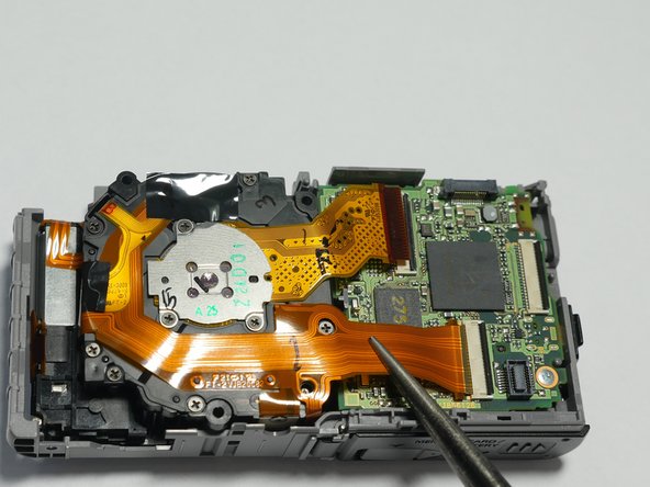

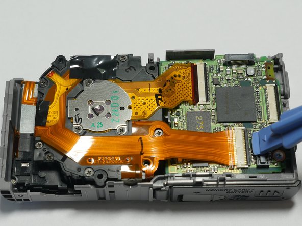

  15. Panasonic Lumix DMC-FH27 Main Board PCB Replacement, Step 4: crwdns2935265:015crwdnd2935265:01crwdnd2935265:02crwdne2935265:0 Panasonic Lumix DMC-FH27 Main Board PCB Replacement, Step 4: crwdns2935265:015crwdnd2935265:02crwdnd2935265:02crwdne2935265:0
    • Use Spudger or other tool and open both cable clamps.

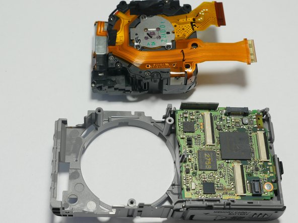

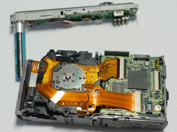

  16. Panasonic Lumix DMC-FH27 Main Board PCB Replacement, Step 5: crwdns2935265:016crwdnd2935265:01crwdnd2935265:03crwdne2935265:0 Panasonic Lumix DMC-FH27 Main Board PCB Replacement, Step 5: crwdns2935265:016crwdnd2935265:02crwdnd2935265:03crwdne2935265:0 Panasonic Lumix DMC-FH27 Main Board PCB Replacement, Step 5: crwdns2935265:016crwdnd2935265:03crwdnd2935265:03crwdne2935265:0
    • Use needle nose pliers or other tool to pull out the cables from the clamps
    • Remove the Lens unit from the camera body.
  17. Panasonic Lumix DMC-FH27 Main Board PCB Replacement, Step 6: crwdns2935265:017crwdnd2935265:01crwdnd2935265:01crwdne2935265:0
  18. Panasonic Lumix DMC-FH27 Main Board PCB Replacement, Main Board PCB: crwdns2935265:018crwdnd2935265:01crwdnd2935265:01crwdne2935265:0
    • Remove screw (0.3mm) from Main PCB
