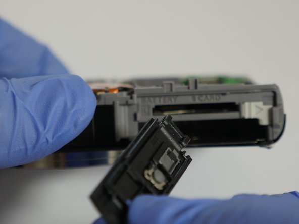

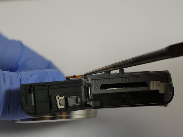

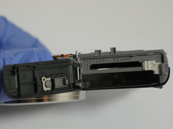

  12. Panasonic Lumix DMC-FH27 Door Replacement, Opening the compartment: crwdns2935265:012crwdnd2935265:01crwdnd2935265:01crwdne2935265:0
    • Open the battery door compartment
  13. Panasonic Lumix DMC-FH27 Door Replacement, Pulling out the rod: crwdns2935265:013crwdnd2935265:01crwdnd2935265:03crwdne2935265:0 Panasonic Lumix DMC-FH27 Door Replacement, Pulling out the rod: crwdns2935265:013crwdnd2935265:02crwdnd2935265:03crwdne2935265:0 Panasonic Lumix DMC-FH27 Door Replacement, Pulling out the rod: crwdns2935265:013crwdnd2935265:03crwdnd2935265:03crwdne2935265:0
    • Lift up the Door rod using needle nose pliers
    • Lift the rod high enough so you can pull it out
    • Use the needle nose pliers to pull out the rod
  14. Panasonic Lumix DMC-FH27 Door Replacement: crwdns2935265:014crwdnd2935265:01crwdnd2935265:03crwdne2935265:0 Panasonic Lumix DMC-FH27 Door Replacement: crwdns2935265:014crwdnd2935265:02crwdnd2935265:03crwdne2935265:0 Panasonic Lumix DMC-FH27 Door Replacement: crwdns2935265:014crwdnd2935265:03crwdnd2935265:03crwdne2935265:0
    • Pull out the rod (don't loose it)
    • Remove the door
