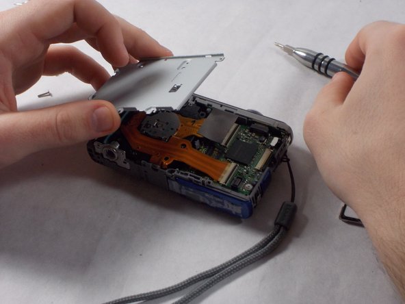

    • Under the screen is a silver panel. Remove three screws using a 00 philips screwdriver and take the plate off.
  11. Panasonic Lumix DMC-FH25 Page Lens Assembly Replacement: crwdns2935265:011crwdnd2935265:01crwdnd2935265:01crwdne2935265:0
    • Remove the silver panel with the buttons and flash battery from the top of the camera. The silver tripod socket may fall out. Do not be alarmed and don't put it back in.

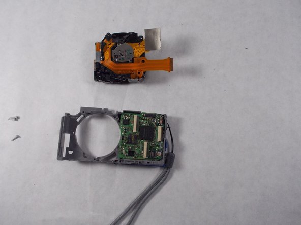

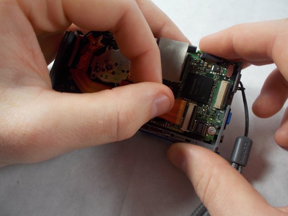

    • Use the pry tool to lift the latches holding the ribbon cables in place. Gently tug on them, careful not to break them. The top ribbon cable will take more effort.
  13. Panasonic Lumix DMC-FH25 Page Lens Assembly Replacement: crwdns2935265:013crwdnd2935265:01crwdnd2935265:02crwdne2935265:0 Panasonic Lumix DMC-FH25 Page Lens Assembly Replacement: crwdns2935265:013crwdnd2935265:02crwdnd2935265:02crwdne2935265:0
    • Gently remove the lens assembly. It should slide out cleanly.
