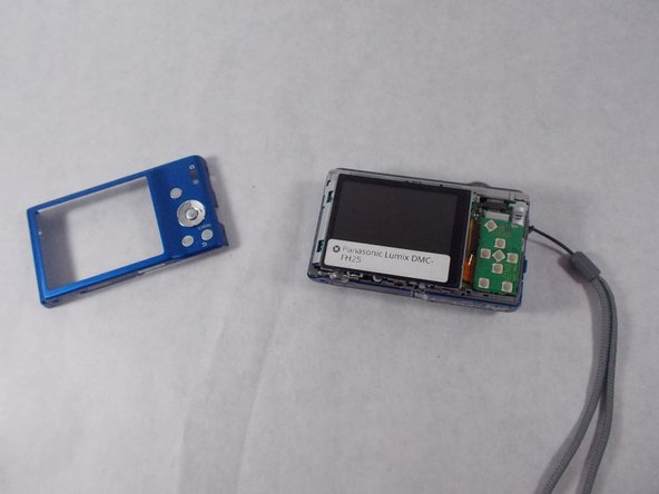

    • Remove 5 screws attached to the back case using a 00 Phillips head screwdriver.
  2. Panasonic Lumix DMC-FH25 LCD Screen Replacement: crwdns2935265:02crwdnd2935265:01crwdnd2935265:01crwdne2935265:0
    • Using your hands and a pry tool, lever the back case off.
  3. Panasonic Lumix DMC-FH25 LCD Screen Replacement: crwdns2935265:03crwdnd2935265:01crwdnd2935265:02crwdne2935265:0 Panasonic Lumix DMC-FH25 LCD Screen Replacement: crwdns2935265:03crwdnd2935265:02crwdnd2935265:02crwdne2935265:0
    • Remove the back case.

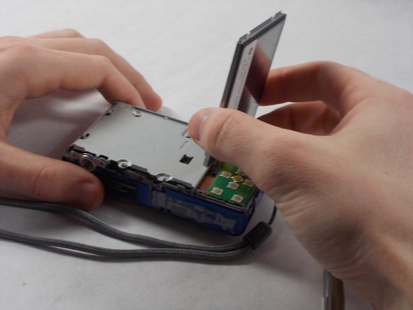

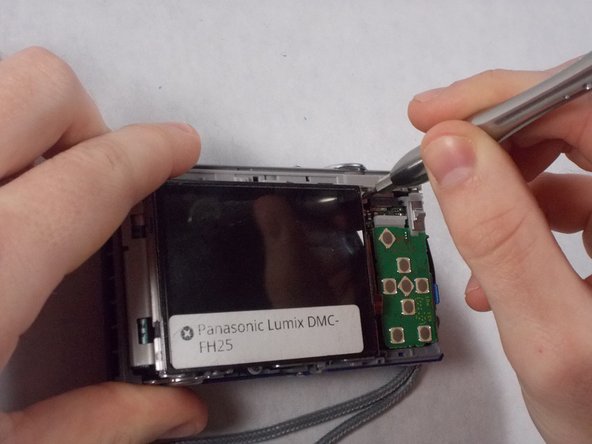

    • Using a 00 Phillips head screwdriver, remove a screw from the top right corner of the screen.
    • Lift the screen, being careful not to tear the ribbon cables on the right side.

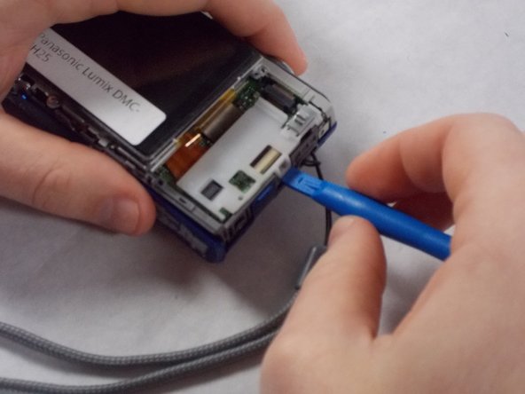

    • Access the ribbon cables by removing the green button receiver panel using a plastic opening tool. There is a white panel beneath. Carefully remove this using a plastic opening tool. The white panel may require some elbow grease to get it off, and the panel may make a snapping sound as it comes off.
  6. Panasonic Lumix DMC-FH25 LCD Screen Replacement: crwdns2935265:06crwdnd2935265:01crwdnd2935265:02crwdne2935265:0 Panasonic Lumix DMC-FH25 LCD Screen Replacement: crwdns2935265:06crwdnd2935265:02crwdnd2935265:02crwdne2935265:0
    • One of the ribbon cables will be housed behind the screen and the other will be under the panels. Gently pull each free from the housing and remove the screen.

It’s usually easier to get the button board and the plastic switch mechanism out first before you unscrew the screen. Then you won’t have to fight the cables at all.
