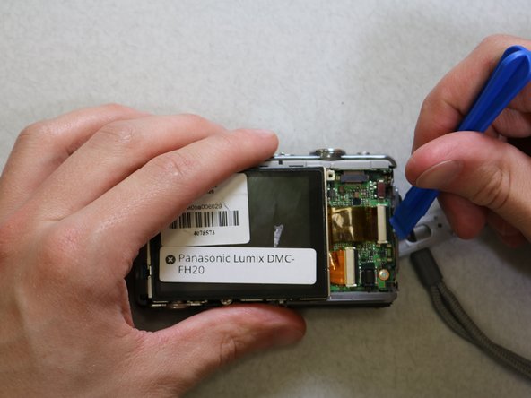

    • Remove all screws (Phillips #000 head) from the sides and bottom of the camera.
  2. Panasonic Lumix DMC-FH20 LCD Screen Replacement: crwdns2935265:02crwdnd2935265:01crwdnd2935265:01crwdne2935265:0

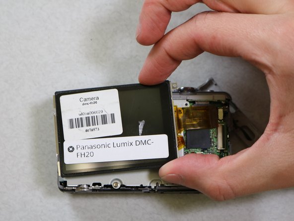

    • Remove the back panel. This might require some extra force. If you still can't get the panel off, try to use a plastic opening tool.

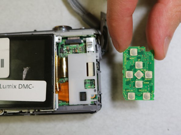

    • Remove the circuit board. You should be able to do this with your fingers. Just grab it and pull upwards. If it does not come, use a plastic opening tool to help.

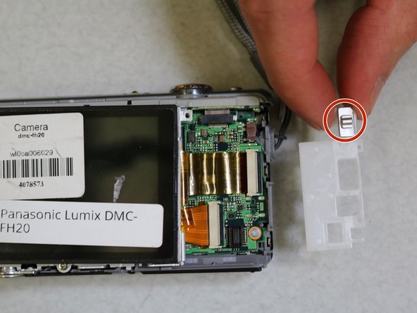

    • Remove the white plastic cover. This may take some extra force. You will want to try to remove from the bottom side first and peel up.
    • Then, where the silver switch is located, it will slide directly out at the top.
