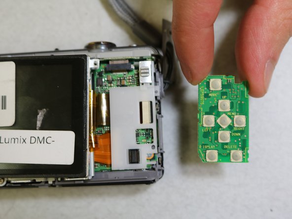

Panasonic Lumix DMC-FH20 Circuit Board Replacement
  1. Panasonic Lumix DMC-FH20 Circuit Board Replacement, Circuit Board: crwdns2935265:01crwdnd2935265:01crwdnd2935265:03crwdne2935265:0 Panasonic Lumix DMC-FH20 Circuit Board Replacement, Circuit Board: crwdns2935265:01crwdnd2935265:02crwdnd2935265:03crwdne2935265:0 Panasonic Lumix DMC-FH20 Circuit Board Replacement, Circuit Board: crwdns2935265:01crwdnd2935265:03crwdnd2935265:03crwdne2935265:0
    • Remove all screws (Phillips #000 head) from the sides and bottom of the camera.
  2. Panasonic Lumix DMC-FH20 Circuit Board Replacement: crwdns2935265:02crwdnd2935265:01crwdnd2935265:01crwdne2935265:0
    • Remove the back panel. This might require some extra force. If you still can't get the panel off, try to use a plastic opening tool.
  3. Panasonic Lumix DMC-FH20 Circuit Board Replacement: crwdns2935265:03crwdnd2935265:01crwdnd2935265:02crwdne2935265:0 Panasonic Lumix DMC-FH20 Circuit Board Replacement: crwdns2935265:03crwdnd2935265:02crwdnd2935265:02crwdne2935265:0
    • Remove the circuit board. You should be able to do this with your fingers. Just grab it and pull upwards. If it does not come, use a plastic opening tool to help.
