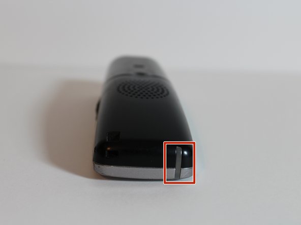

    • On the back of the phone, remove battery cover.
    • Push down on the marked indentation and pull downwards.
