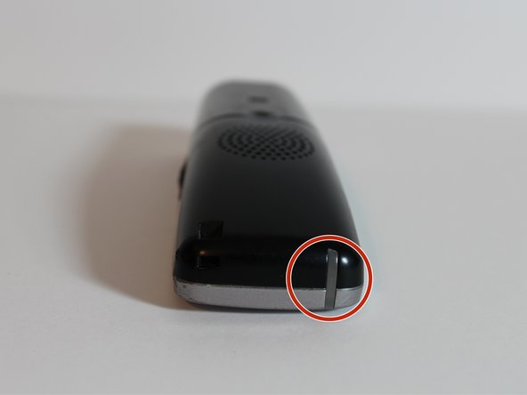

    • On the back of the phone, remove battery cover.
    • Push down on the marked indentation and pull downwards.

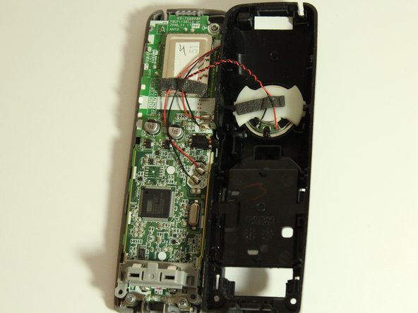

  4. Panasonic KX-TGA600M Keypad Replacement: crwdns2935265:04crwdnd2935265:01crwdnd2935265:03crwdne2935265:0 Panasonic KX-TGA600M Keypad Replacement: crwdns2935265:04crwdnd2935265:02crwdnd2935265:03crwdne2935265:0 Panasonic KX-TGA600M Keypad Replacement: crwdns2935265:04crwdnd2935265:03crwdnd2935265:03crwdne2935265:0
    • Pull the phone apart. The plastic opening tool may be needed.
    • The clear light piece will fall out, so make sure you place it next to the screws.

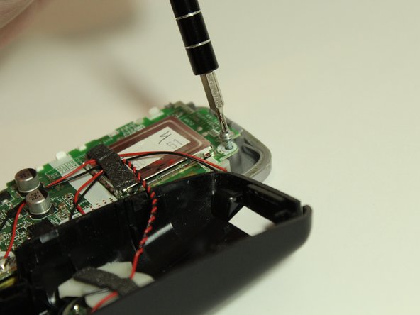

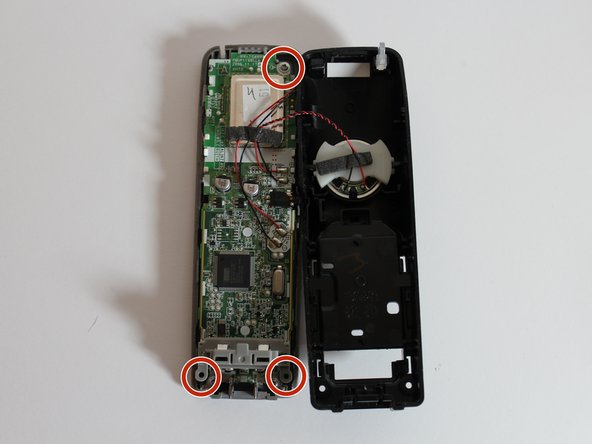

  5. Panasonic KX-TGA600M Keypad Replacement: crwdns2935265:05crwdnd2935265:01crwdnd2935265:03crwdne2935265:0 Panasonic KX-TGA600M Keypad Replacement: crwdns2935265:05crwdnd2935265:02crwdnd2935265:03crwdne2935265:0 Panasonic KX-TGA600M Keypad Replacement: crwdns2935265:05crwdnd2935265:03crwdnd2935265:03crwdne2935265:0
    • Use the Phillips #00 screwdriver to remove the three screws holding the circuit-board in place.
    • The screws are located in the top right corner, bottom left corner, and bottom right corner.
