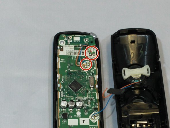

  3. Panasonic KX-TG6641 Wire Replacement, Damaged Wire: crwdns2935265:03crwdnd2935265:01crwdnd2935265:01crwdne2935265:0
    • Unscrew the two screw at the bottom of the device.
  4. Panasonic KX-TG6641 Wire Replacement: crwdns2935265:04crwdnd2935265:01crwdnd2935265:01crwdne2935265:0
    • Using the iFixit opening tool, pry open the back of the phone.
  5. Panasonic KX-TG6641 Wire Replacement: crwdns2935265:05crwdnd2935265:01crwdnd2935265:02crwdne2935265:0 Panasonic KX-TG6641 Wire Replacement: crwdns2935265:05crwdnd2935265:02crwdnd2935265:02crwdne2935265:0
    • Identify damaged or loose wires. If loose, adjust till properly placed. If damaged, solder the new wire(s) to the mother board or desired location.
