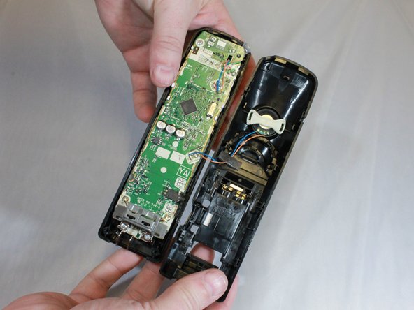

    • In order to remove the back of the phone, unscrew the two screws at the bottom corners on the back of the phone.
  4. Panasonic KX-TG6641 Earpiece Replacement: crwdns2935265:04crwdnd2935265:01crwdnd2935265:02crwdne2935265:0 Panasonic KX-TG6641 Earpiece Replacement: crwdns2935265:04crwdnd2935265:02crwdnd2935265:02crwdne2935265:0
    • In order to remove the back of the phone, pry the back open by inserting the iFixit Opening tool in the space between the front and back of the phone.
  5. Panasonic KX-TG6641 Earpiece Replacement: crwdns2935265:05crwdnd2935265:01crwdnd2935265:02crwdne2935265:0 Panasonic KX-TG6641 Earpiece Replacement: crwdns2935265:05crwdnd2935265:02crwdnd2935265:02crwdne2935265:0

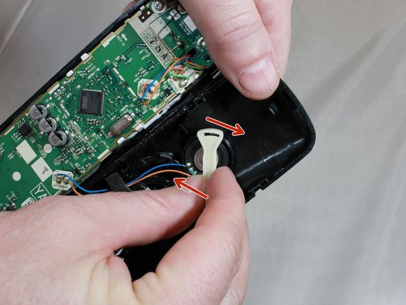

    • Remove the earpiece cover by twisting the plastic earpiece clockwise to unlock.
