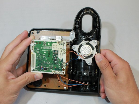

    • To access the display screen, use a Phillips #0 screwdriver to remove the screw on the bottom right corner of the electrical panel.
    • Unclip the wires hooked into the base.
    • It's not necessary to desolder the wires.
  4. Panasonic KX-TG6641 Base Display Screen Replacement: crwdns2935265:04crwdnd2935265:01crwdnd2935265:01crwdne2935265:0
    • Disconnect the two phone cable connectors.
    • Use a Phillips #0 to remove the screw that is fixed in the plastic holder for the connectors.
  5. Panasonic KX-TG6641 Base Display Screen Replacement: crwdns2935265:05crwdnd2935265:01crwdnd2935265:02crwdne2935265:0 Panasonic KX-TG6641 Base Display Screen Replacement: crwdns2935265:05crwdnd2935265:02crwdnd2935265:02crwdne2935265:0

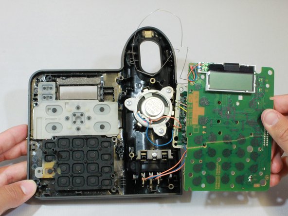

    • Move the electrical panel to the side.
    • Use a Phillips #0 to remove the four screws from the brown board and lift it to access the display screen.
    • Be aware, there is a screw under the control panel, it is indicated with the central red circle.
  6. Panasonic KX-TG6641 Base Display Screen Replacement: crwdns2935265:06crwdnd2935265:01crwdnd2935265:01crwdne2935265:0
    • Remove the current display screen from the electric panel.
    • Follow this process in reverse to replace the new display screen in its place.
