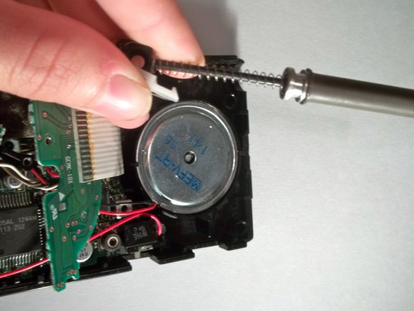

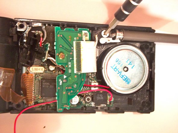

  3. Panasonic KX-T4000R Cordless Phone Antenna Replacement, Antenna: crwdns2935265:03crwdnd2935265:01crwdnd2935265:02crwdne2935265:0 Panasonic KX-T4000R Cordless Phone Antenna Replacement, Antenna: crwdns2935265:03crwdnd2935265:02crwdnd2935265:02crwdne2935265:0
    • Find the silver screw located in the red circle.
    • Using a Philips head #2 screwdriver, remove the screw holding the antenna in place.
  4. Panasonic KX-T4000R Cordless Phone Antenna Replacement: crwdns2935265:04crwdnd2935265:01crwdnd2935265:02crwdne2935265:0 Panasonic KX-T4000R Cordless Phone Antenna Replacement: crwdns2935265:04crwdnd2935265:02crwdnd2935265:02crwdne2935265:0
    • Press the release button.
    • The release button is located in the red circle in the image to the left.
