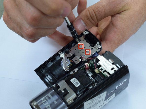

    • Take off the side panel.
    • Remove the screw on the screen side of the camera and above the battery chamber.
    • Use the spudger to remove the top panel of the camcorder.
  2. Panasonic HDC-TM90 Zoom Toggle Cleaning: crwdns2935265:02crwdnd2935265:01crwdnd2935265:01crwdne2935265:0
    • Unscrew the silver metal plate from under the top of the camera.
  3. Panasonic HDC-TM90 Zoom Toggle Cleaning: crwdns2935265:03crwdnd2935265:01crwdnd2935265:02crwdne2935265:0 Panasonic HDC-TM90 Zoom Toggle Cleaning: crwdns2935265:03crwdnd2935265:02crwdnd2935265:02crwdne2935265:0
    • Unscrew the second metal plate from under the top of the camera.
    • When reassembling, be sure to place the circular speaker component in its correct position.
