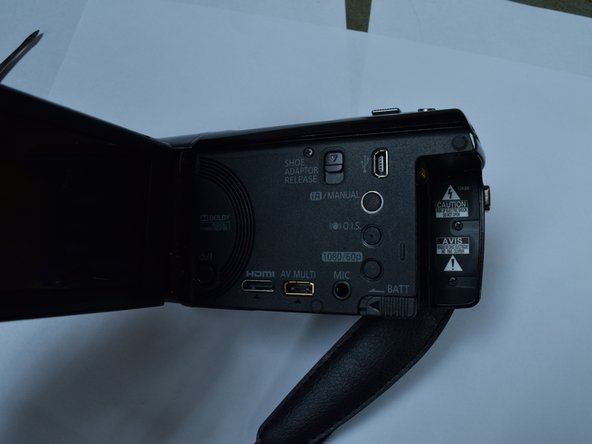

    • Open the LCD screen.
  2. Panasonic HDC-TM90 LCD Screen Replacement: crwdns2935265:02crwdnd2935265:01crwdnd2935265:01crwdne2935265:0
    • Slide the battery release switch away from the battery.
  3. Panasonic HDC-TM90 LCD Screen Replacement: crwdns2935265:03crwdnd2935265:01crwdnd2935265:01crwdne2935265:0
    • While holding the switch away from the battery, push the battery out of the slot.
  4. Panasonic HDC-TM90 LCD Screen Replacement: crwdns2935265:04crwdnd2935265:01crwdnd2935265:01crwdne2935265:0
    • Remove the battery from the camera.

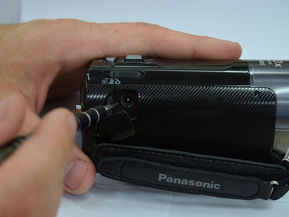

  5. Panasonic HDC-TM90 LCD Screen Replacement, Lens: crwdns2935265:05crwdnd2935265:01crwdnd2935265:03crwdne2935265:0 Panasonic HDC-TM90 LCD Screen Replacement, Lens: crwdns2935265:05crwdnd2935265:02crwdnd2935265:03crwdne2935265:0 Panasonic HDC-TM90 LCD Screen Replacement, Lens: crwdns2935265:05crwdnd2935265:03crwdnd2935265:03crwdne2935265:0
    • Remove 5 screws from the side panel body of the camcorder.
    • Use the spudger to remove the top of the camcorder.

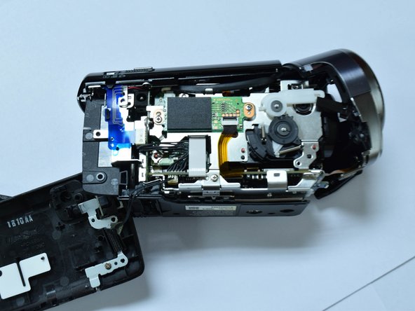

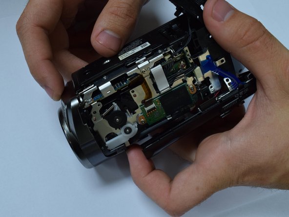

  9. Panasonic HDC-TM90 LCD Screen Replacement, LCD Screen: crwdns2935265:09crwdnd2935265:01crwdnd2935265:02crwdne2935265:0 Panasonic HDC-TM90 LCD Screen Replacement, LCD Screen: crwdns2935265:09crwdnd2935265:02crwdnd2935265:02crwdne2935265:0
    • Remove the side panel of the camcorder.
    • Remove the top panel of the camcorder.
    • For help with this step see prerequisite guide: Lens Clean.

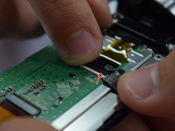

  13. Panasonic HDC-TM90 LCD Screen Replacement: crwdns2935265:013crwdnd2935265:01crwdnd2935265:02crwdne2935265:0 Panasonic HDC-TM90 LCD Screen Replacement: crwdns2935265:013crwdnd2935265:02crwdnd2935265:02crwdne2935265:0
    • Peel back the black tape holding the wire strip to the camcorder screen.
    • Unclip the small latch from the wire strip.
