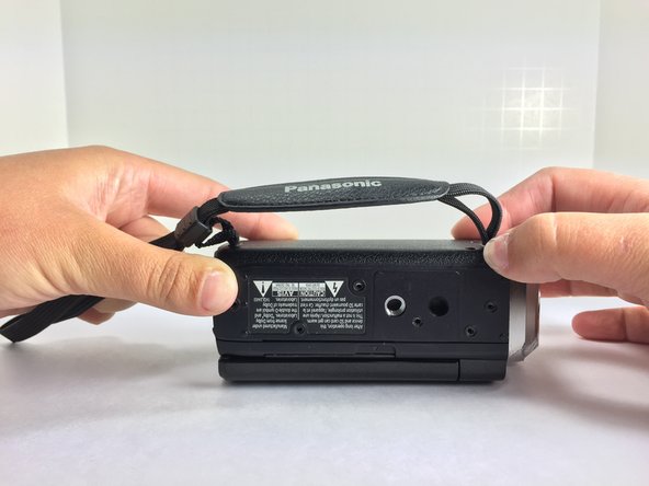

    • Using the Phillips #00 Screwdriver, unscrew the five .5 mm Phillips #00 screws on the hand-strap side of the camcorder.
  2. Panasonic HDC-TM15 Side Cover Replacement: crwdns2935265:02crwdnd2935265:01crwdnd2935265:01crwdne2935265:0
    • Next, unscrew the six .5 mm Phillips #00 screws on the bottom of the camcorder.

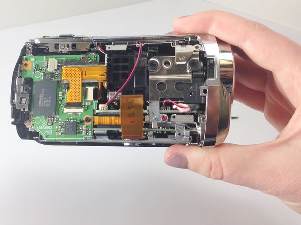

    • By putting your hand through the hand-strap, tug on the side cover until it comes off completely.
    • Once the old cover is completely detached, set it aside.
    • The inside of your camcorder should now be completely exposed, as seen in the photos.
