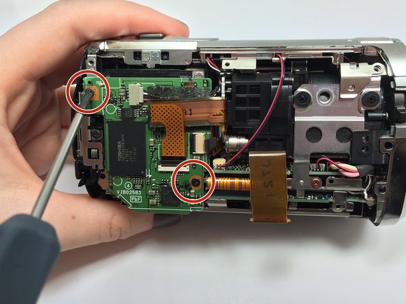

  4. Panasonic HDC-TM15 Record Button Replacement: crwdns2935265:04crwdnd2935265:01crwdnd2935265:02crwdne2935265:0 Panasonic HDC-TM15 Record Button Replacement: crwdns2935265:04crwdnd2935265:02crwdnd2935265:02crwdne2935265:0
    • Unscrew the two 1 mm Phillips #00 black screws in the corners of the green memory card reader.
    • The screws should be surrounded by orange circles.

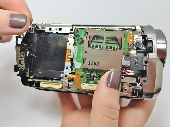

  6. Panasonic HDC-TM15 Record Button Replacement: crwdns2935265:06crwdnd2935265:01crwdnd2935265:02crwdne2935265:0 Panasonic HDC-TM15 Record Button Replacement: crwdns2935265:06crwdnd2935265:02crwdnd2935265:02crwdne2935265:0
    • Unscrew the 1.2 mm Phillips #00 black screw beneath the motherboard on the bottom of the camcorder.
    • The green motherboard should now be partially detached, as shown in the photo.

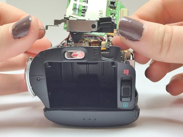

  7. Panasonic HDC-TM15 Record Button Replacement: crwdns2935265:07crwdnd2935265:01crwdnd2935265:03crwdne2935265:0 Panasonic HDC-TM15 Record Button Replacement: crwdns2935265:07crwdnd2935265:02crwdnd2935265:03crwdne2935265:0 Panasonic HDC-TM15 Record Button Replacement: crwdns2935265:07crwdnd2935265:03crwdnd2935265:03crwdne2935265:0
    • Remove the long silver plate that secures the record button.

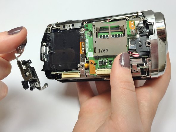

  8. Panasonic HDC-TM15 Record Button Replacement: crwdns2935265:08crwdnd2935265:01crwdnd2935265:01crwdne2935265:0
    • Remove the old record button from beneath the silver plate.

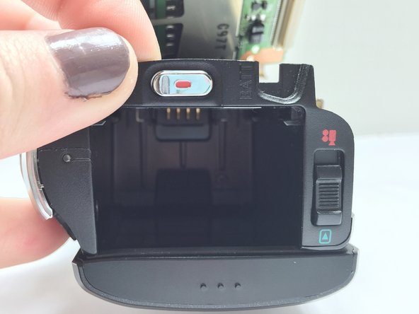

  10. Panasonic HDC-TM15 Record Button Replacement: crwdns2935265:010crwdnd2935265:01crwdnd2935265:02crwdne2935265:0 Panasonic HDC-TM15 Record Button Replacement: crwdns2935265:010crwdnd2935265:02crwdnd2935265:02crwdne2935265:0
    • Slide the silver plate into place beside the new Record button.
    • Ensure that the Battery Eject button is lined up properly.
