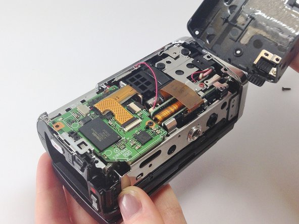

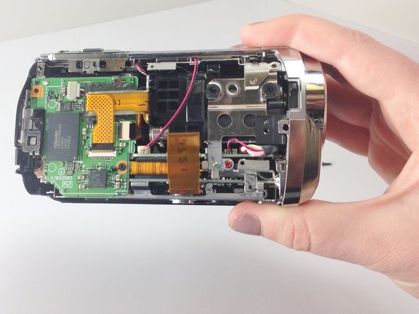

    • Once all eleven screws have been removed, put your hand through the hand-strap and tug on the side cover until it comes off completely.
    • The inside of your camcorder should now be completely exposed, as shown in the photos.

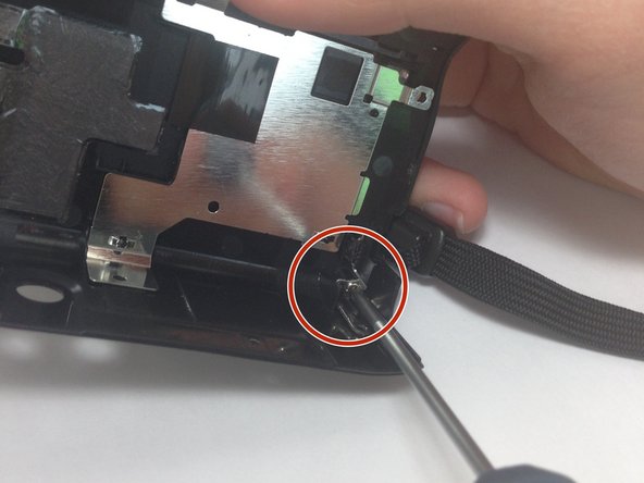

  4. Panasonic HDC-TM15 Hand-Strap Replacement: crwdns2935265:04crwdnd2935265:01crwdnd2935265:03crwdne2935265:0 Panasonic HDC-TM15 Hand-Strap Replacement: crwdns2935265:04crwdnd2935265:02crwdnd2935265:03crwdne2935265:0 Panasonic HDC-TM15 Hand-Strap Replacement: crwdns2935265:04crwdnd2935265:03crwdnd2935265:03crwdne2935265:0

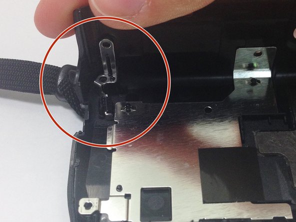

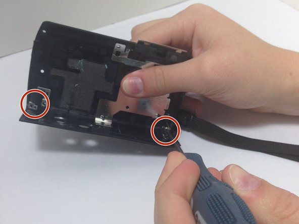

    • For the remainder of the hand-strap replacement, you will only be working with the side cover of the camcorder.
    • Unscrew the two silver .5 mm Phillips #00 screws located in the bottom corners of the inside of the side cover. This will release the two silver plates that hold the hand-strap in place.

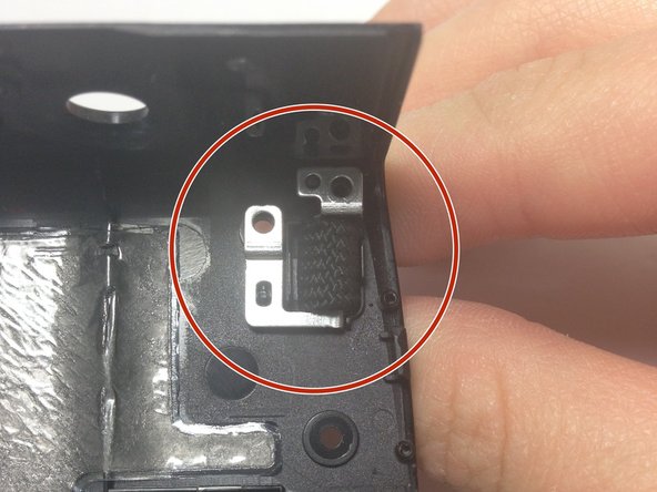

  5. Panasonic HDC-TM15 Hand-Strap Replacement: crwdns2935265:05crwdnd2935265:01crwdnd2935265:02crwdne2935265:0 Panasonic HDC-TM15 Hand-Strap Replacement: crwdns2935265:05crwdnd2935265:02crwdnd2935265:02crwdne2935265:0
    • Remove the two silver plates from the loops of the hand-strap.

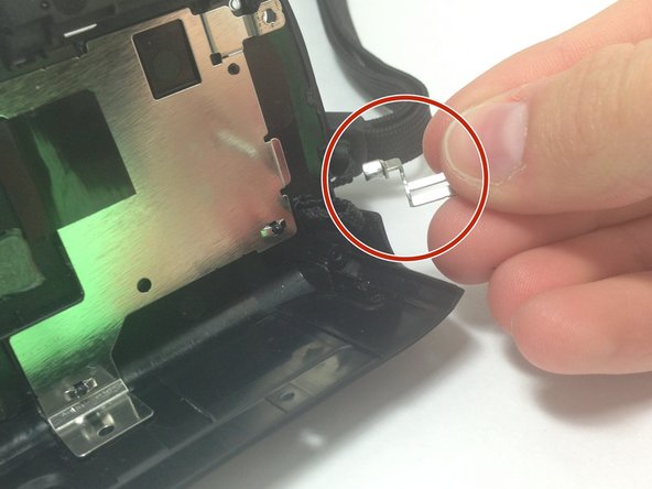

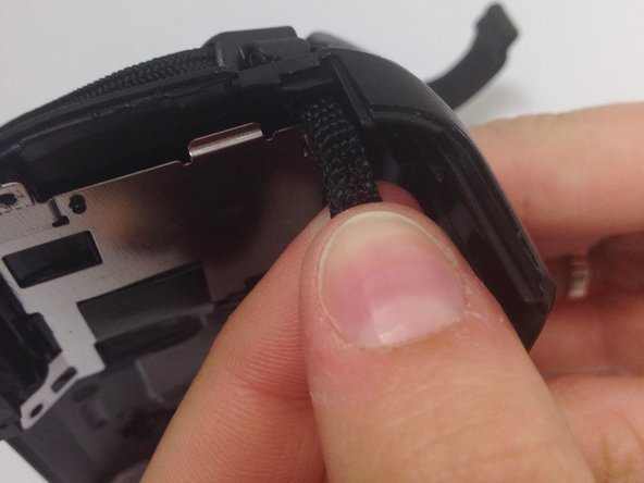

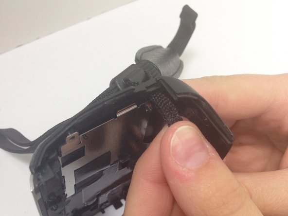

  6. Panasonic HDC-TM15 Hand-Strap Replacement: crwdns2935265:06crwdnd2935265:01crwdnd2935265:01crwdne2935265:0
    • Pull the hand-strap through the holes of the side cover, until it is completely detached.
    • Set the old hand-strap aside.

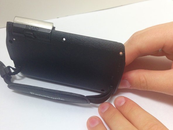

  13. Panasonic HDC-TM15 Hand-Strap Replacement: crwdns2935265:013crwdnd2935265:01crwdnd2935265:01crwdne2935265:0
    • When the side cover is securely fastened, you have completed the hand-strap replacement of your Panasonic HDC-TM15 camcorder.
