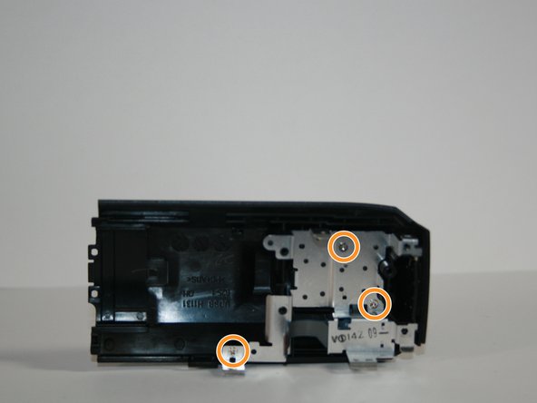

  6. Panasonic HC‑VX870 Shoe Adapter Replacement: crwdns2935265:06crwdnd2935265:01crwdnd2935265:02crwdne2935265:0 Panasonic HC‑VX870 Shoe Adapter Replacement: crwdns2935265:06crwdnd2935265:02crwdnd2935265:02crwdne2935265:0
    • Unscrew the indicated screws and remove the piece they hold in place.

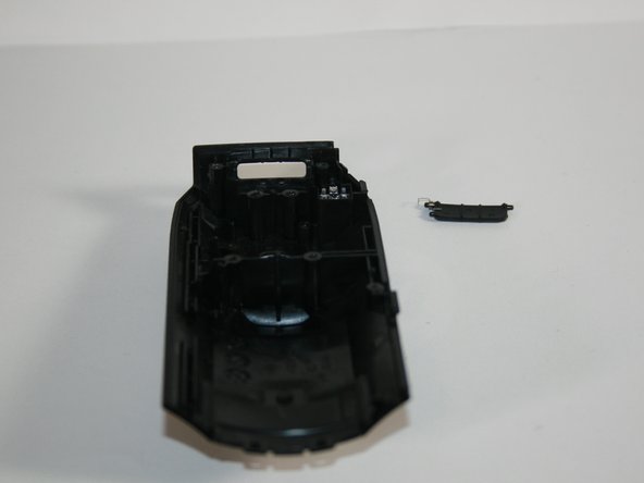

  7. Panasonic HC‑VX870 Shoe Adapter Replacement: crwdns2935265:07crwdnd2935265:01crwdnd2935265:02crwdne2935265:0 Panasonic HC‑VX870 Shoe Adapter Replacement: crwdns2935265:07crwdnd2935265:02crwdnd2935265:02crwdne2935265:0
    • Remove the shoe adapter by simply pulling it out of its place.
    • Be sure not to loose the tiny spring that is attached to the shoe adapter as you are removing it.
