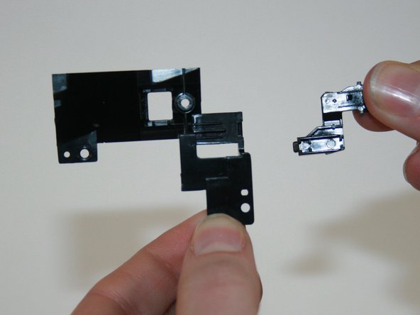

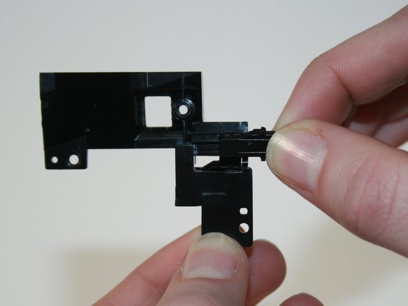

  5. Panasonic HC‑VX870 Hand Strap Replacement: crwdns2935265:05crwdnd2935265:01crwdnd2935265:03crwdne2935265:0 Panasonic HC‑VX870 Hand Strap Replacement: crwdns2935265:05crwdnd2935265:02crwdnd2935265:03crwdne2935265:0 Panasonic HC‑VX870 Hand Strap Replacement: crwdns2935265:05crwdnd2935265:03crwdnd2935265:03crwdne2935265:0
    • Take out the piece that that was held in place by the screw and separate the smaller piece from the larger piece.
