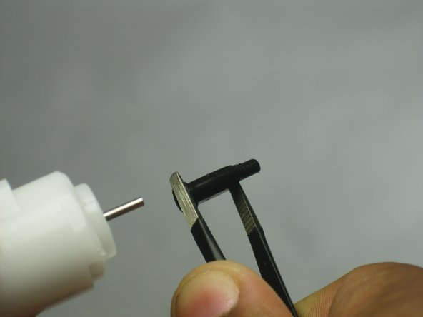

  7. Panasonic ER-GN30-K Motor Replacement: crwdns2935265:07crwdnd2935265:01crwdnd2935265:02crwdne2935265:0 Panasonic ER-GN30-K Motor Replacement: crwdns2935265:07crwdnd2935265:02crwdnd2935265:02crwdne2935265:0
    • Use a pair of tweezers to remove the plastic cover of the motor shaft by pulling it away from the motor.
