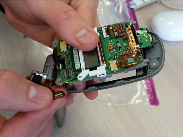

  6. Panasonic EB-GD88 Camera Replacement, Camera: crwdns2935265:06crwdnd2935265:01crwdnd2935265:02crwdne2935265:0 Panasonic EB-GD88 Camera Replacement, Camera: crwdns2935265:06crwdnd2935265:02crwdnd2935265:02crwdne2935265:0
    • Use fingers to pop up gold piece (below the antenna).
  7. Panasonic EB-GD88 Camera Replacement: crwdns2935265:07crwdnd2935265:01crwdnd2935265:01crwdne2935265:0
    • Flip up circuit board and screen.
  8. Panasonic EB-GD88 Camera Replacement: crwdns2935265:08crwdnd2935265:01crwdnd2935265:01crwdne2935265:0
    • Pull off gray cover with black circular camera piece at the bottom of the screen.
  9. Panasonic EB-GD88 Camera Replacement: crwdns2935265:09crwdnd2935265:01crwdnd2935265:01crwdne2935265:0
    • Use fingers to slide camera out of slot.
