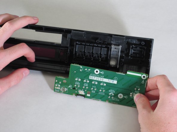

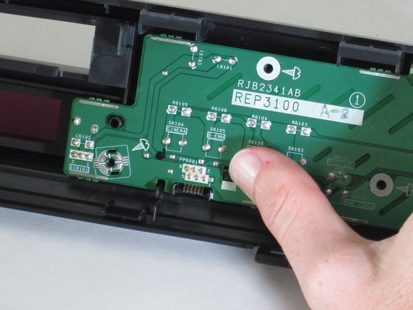

  6. Panasonic DVD-RV31 Player Right Function Board Replacement, Right Function Board: crwdns2935265:06crwdnd2935265:01crwdnd2935265:01crwdne2935265:0
    • Remove 4 screws as shown.
  7. Panasonic DVD-RV31 Player Right Function Board Replacement: crwdns2935265:07crwdnd2935265:01crwdnd2935265:03crwdne2935265:0 Panasonic DVD-RV31 Player Right Function Board Replacement: crwdns2935265:07crwdnd2935265:02crwdnd2935265:03crwdne2935265:0 Panasonic DVD-RV31 Player Right Function Board Replacement: crwdns2935265:07crwdnd2935265:03crwdnd2935265:03crwdne2935265:0
    • Push in plastic retainer tab on board.
    • Grasp edges of board and pull out.
