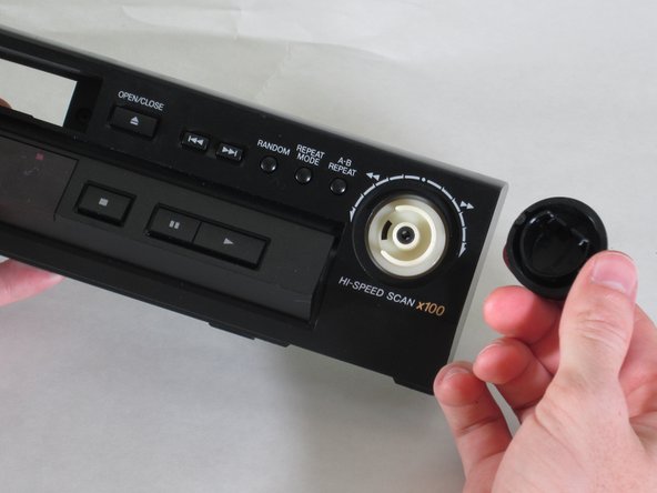

    1. Panasonic DVD-RV31 Player Left Control Board Replacement, Left Control Board: crwdns2935265:04crwdnd2935265:01crwdnd2935265:02crwdne2935265:0 Panasonic DVD-RV31 Player Left Control Board Replacement, Left Control Board: crwdns2935265:04crwdnd2935265:02crwdnd2935265:02crwdne2935265:0
      • Grip jogger dial and lift up. It should come off easily.
    2. Panasonic DVD-RV31 Player Left Control Board Replacement: crwdns2935265:05crwdnd2935265:01crwdnd2935265:03crwdne2935265:0 Panasonic DVD-RV31 Player Left Control Board Replacement: crwdns2935265:05crwdnd2935265:02crwdnd2935265:03crwdne2935265:0 Panasonic DVD-RV31 Player Left Control Board Replacement: crwdns2935265:05crwdnd2935265:03crwdnd2935265:03crwdne2935265:0
      • Remove 4 mounting screws as shown.
      • Unscrew and save brass tab.
      • Push in 2 plastic retainers and lift out.
