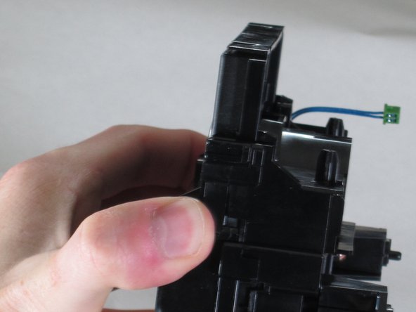

    3. Panasonic DVD-RV31 Player Disc Retainer Replacement: crwdns2935265:08crwdnd2935265:01crwdnd2935265:01crwdne2935265:0
      • With the drive assembly separate from the player, hold as shown and pull the bracket edges away from the disk drive.
      • Lift bracket off and reserve for re-assembly.

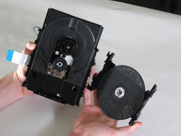

    1. Panasonic DVD-RV31 Player Disc Retainer Replacement, Disc Retainer: crwdns2935265:09crwdnd2935265:01crwdnd2935265:03crwdne2935265:0 Panasonic DVD-RV31 Player Disc Retainer Replacement, Disc Retainer: crwdns2935265:09crwdnd2935265:02crwdnd2935265:03crwdne2935265:0 Panasonic DVD-RV31 Player Disc Retainer Replacement, Disc Retainer: crwdns2935265:09crwdnd2935265:03crwdnd2935265:03crwdne2935265:0
      • Grasp the bridge above the wheel and push the tabs on the side as shown.
      • Pull down firmly and away from the laser housing.
