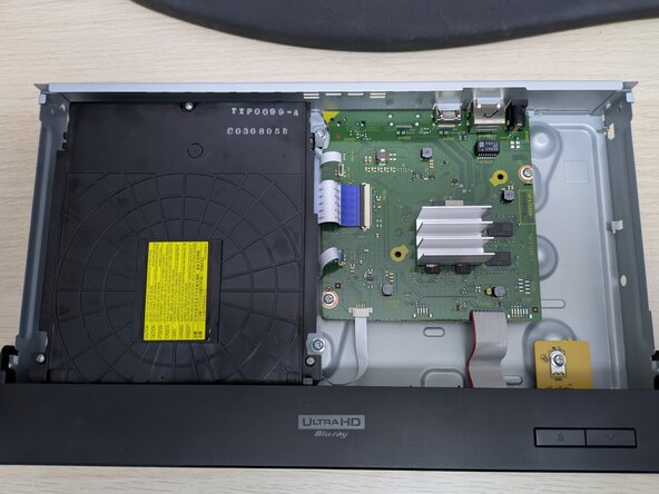

    • Press the eject button to open the disc tray.
    • Unplug the power adaptor to leave the tray open.
    • Unplug any other cables.

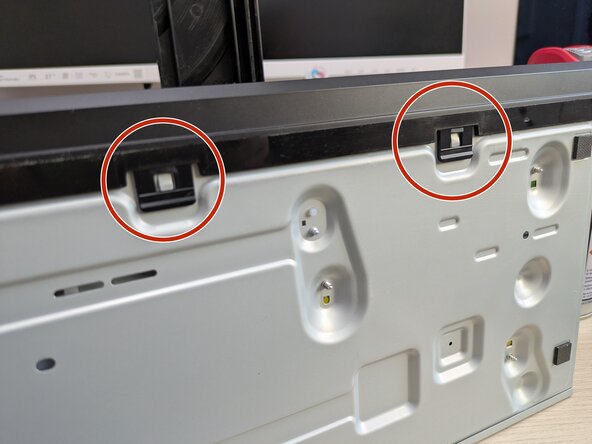

    • Remove the 3 Phillips screws from the back of the case.
    • Slide the top case up and back to remove it.
    • It helps if you pull the left and right sides out a bit to clear the base.

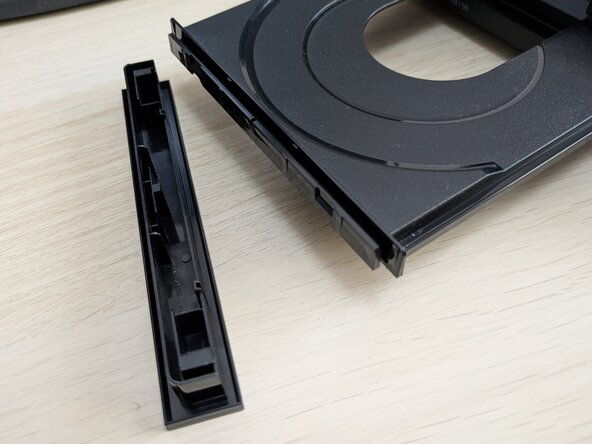

  3. Panasonic DP-UB150-K Laser Replacement, Remove disc tray front: crwdns2935265:03crwdnd2935265:01crwdnd2935265:02crwdne2935265:0 Panasonic DP-UB150-K Laser Replacement, Remove disc tray front: crwdns2935265:03crwdnd2935265:02crwdnd2935265:02crwdne2935265:0

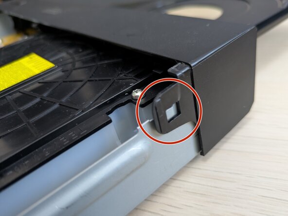

    • Unclip the front of the disc tray.
    • Support the tray while you unclip the front.
    • It should slide up and off.

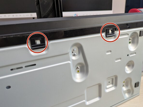

  4. Panasonic DP-UB150-K Laser Replacement, Remove case front: crwdns2935265:04crwdnd2935265:01crwdnd2935265:03crwdne2935265:0 Panasonic DP-UB150-K Laser Replacement, Remove case front: crwdns2935265:04crwdnd2935265:02crwdnd2935265:03crwdne2935265:0 Panasonic DP-UB150-K Laser Replacement, Remove case front: crwdns2935265:04crwdnd2935265:03crwdnd2935265:03crwdne2935265:0

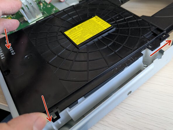

    • Release the latches on the left and right sides plus the two underneath.
    • Slide the front off and guide it over the open disc tray.

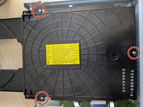

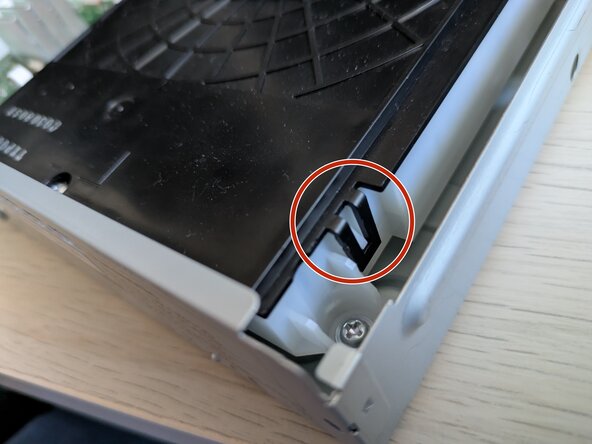

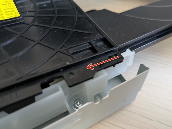

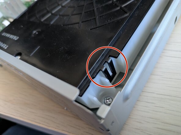

  5. Panasonic DP-UB150-K Laser Replacement, Loosen drive lid: crwdns2935265:05crwdnd2935265:01crwdnd2935265:03crwdne2935265:0 Panasonic DP-UB150-K Laser Replacement, Loosen drive lid: crwdns2935265:05crwdnd2935265:02crwdnd2935265:03crwdne2935265:0 Panasonic DP-UB150-K Laser Replacement, Loosen drive lid: crwdns2935265:05crwdnd2935265:03crwdnd2935265:03crwdne2935265:0
    • Remove the 3 Phillips screws from the drive lid.
    • Unlatch the left and right sides.
  6. Panasonic DP-UB150-K Laser Replacement, Remove the drive cover: crwdns2935265:06crwdnd2935265:01crwdnd2935265:02crwdne2935265:0 Panasonic DP-UB150-K Laser Replacement, Remove the drive cover: crwdns2935265:06crwdnd2935265:02crwdnd2935265:02crwdne2935265:0
    • Lift the drive cover slightly up at the rear.
    • Slide it back to clear the retaining slots at the front.

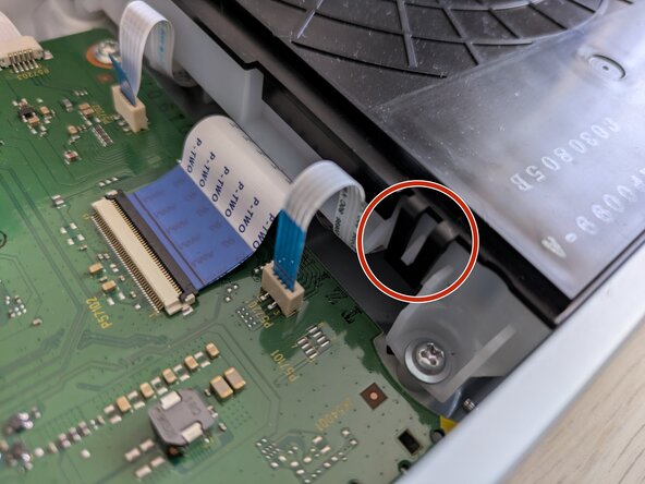

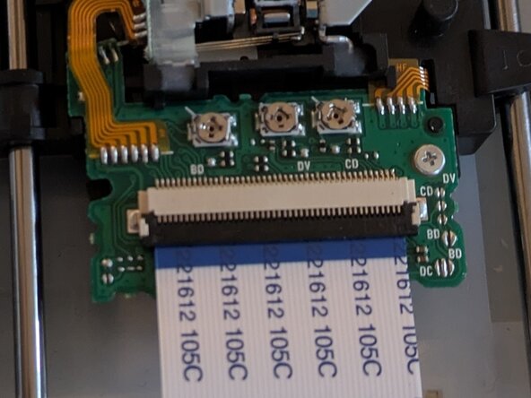

  7. Panasonic DP-UB150-K Laser Replacement, Disconnect laser ribbon cable: crwdns2935265:07crwdnd2935265:01crwdnd2935265:03crwdne2935265:0 Panasonic DP-UB150-K Laser Replacement, Disconnect laser ribbon cable: crwdns2935265:07crwdnd2935265:02crwdnd2935265:03crwdne2935265:0 Panasonic DP-UB150-K Laser Replacement, Disconnect laser ribbon cable: crwdns2935265:07crwdnd2935265:03crwdnd2935265:03crwdne2935265:0
    • With the drive open you should now see the laser unit mounted on rails and driven by a motor.
    • Gently open the black retaining clip on the laser unit ribbon connector.
    • Disconnect the ribbon cable.

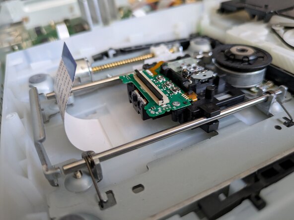

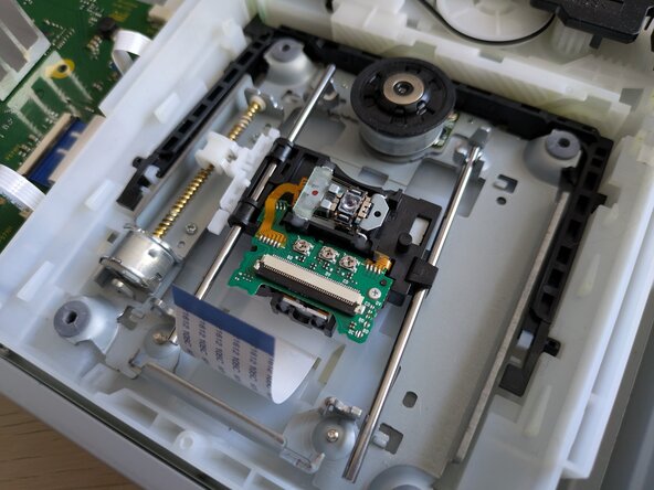

  8. Panasonic DP-UB150-K Laser Replacement, Unclip rails: crwdns2935265:08crwdnd2935265:01crwdnd2935265:03crwdne2935265:0 Panasonic DP-UB150-K Laser Replacement, Unclip rails: crwdns2935265:08crwdnd2935265:02crwdnd2935265:03crwdne2935265:0 Panasonic DP-UB150-K Laser Replacement, Unclip rails: crwdns2935265:08crwdnd2935265:03crwdnd2935265:03crwdne2935265:0

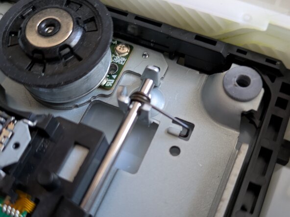

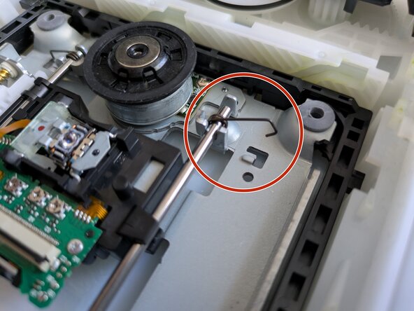

    • Unhook the 4 spring clips holding the rails in place. There are 2 clips per rail.
    • You may need to use a screwdriver to guide the hooks free so be very careful not to damage the delicate ribbon cable.
    • With the rails free you can now lift them and the laser unit out of the drive.

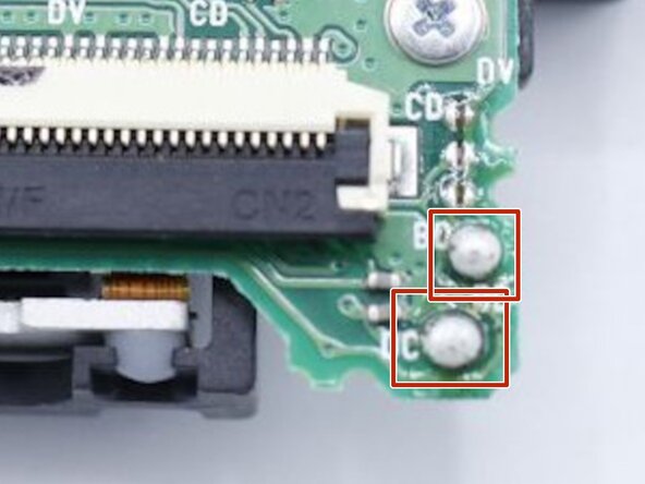

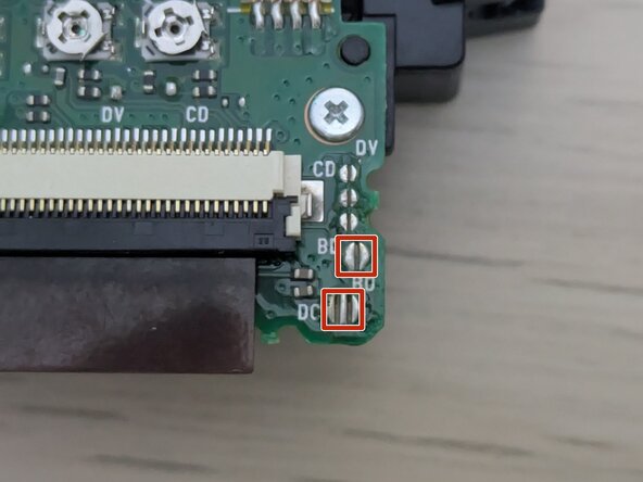

  9. Panasonic DP-UB150-K Laser Replacement, Remove laser antistatic solder points: crwdns2935265:09crwdnd2935265:01crwdnd2935265:03crwdne2935265:0 Panasonic DP-UB150-K Laser Replacement, Remove laser antistatic solder points: crwdns2935265:09crwdnd2935265:02crwdnd2935265:03crwdne2935265:0 Panasonic DP-UB150-K Laser Replacement, Remove laser antistatic solder points: crwdns2935265:09crwdnd2935265:03crwdnd2935265:03crwdne2935265:0
    • My "new" laser appeared to be used so I didn't need to remove any antistatic solder points.
    • A parts catalogue (https://fixpart.co.uk/product/panasonic-...) shows solder across a couple of points on the lower right hand side of the laser.
    • If these are present on your new laser you need to remove them with a soldering iron. You may get away with just touching the iron onto them but don't be surprised if you need to use some desoldering wick.

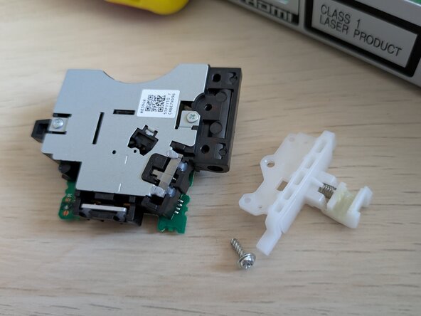

  10. Panasonic DP-UB150-K Laser Replacement, Transfer motor arm from old laser: crwdns2935265:010crwdnd2935265:01crwdnd2935265:02crwdne2935265:0 Panasonic DP-UB150-K Laser Replacement, Transfer motor arm from old laser: crwdns2935265:010crwdnd2935265:02crwdnd2935265:02crwdne2935265:0
    • Turn the old laser unit over. Remove the screw holding the white motor arm in place. Fit it to the new laser unit.

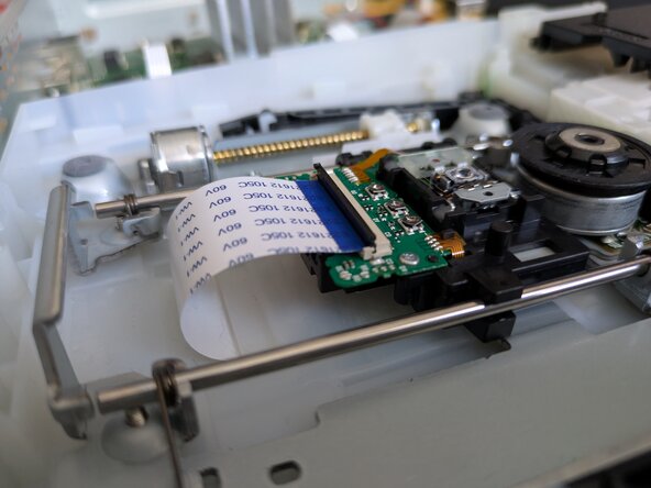

  11. Panasonic DP-UB150-K Laser Replacement, Remount laser, rails and clips: crwdns2935265:011crwdnd2935265:01crwdnd2935265:03crwdne2935265:0 Panasonic DP-UB150-K Laser Replacement, Remount laser, rails and clips: crwdns2935265:011crwdnd2935265:02crwdnd2935265:03crwdne2935265:0 Panasonic DP-UB150-K Laser Replacement, Remount laser, rails and clips: crwdns2935265:011crwdnd2935265:03crwdnd2935265:03crwdne2935265:0

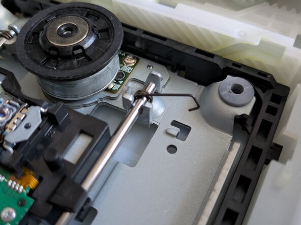

    • Mount the laser on the rails. Add a spring clip to the end of each rail.
    • Insert back into the drive while making sure the white arm on the side of the laser unit engages with the worm gear.
    • Hook each of the spring clips into place. Make sure the clips are under tension and aren't loose.
    • You may need to use a screwdriver to push them into place. Be careful not to damage the ribbon cable.
  12. Panasonic DP-UB150-K Laser Replacement, Connect laser ribbon cable: crwdns2935265:012crwdnd2935265:01crwdnd2935265:03crwdne2935265:0 Panasonic DP-UB150-K Laser Replacement, Connect laser ribbon cable: crwdns2935265:012crwdnd2935265:02crwdnd2935265:03crwdne2935265:0 Panasonic DP-UB150-K Laser Replacement, Connect laser ribbon cable: crwdns2935265:012crwdnd2935265:03crwdnd2935265:03crwdne2935265:0
    • Insert the ribbon connector and make sure it is lined up and square.
    • Close the black retaining clip.

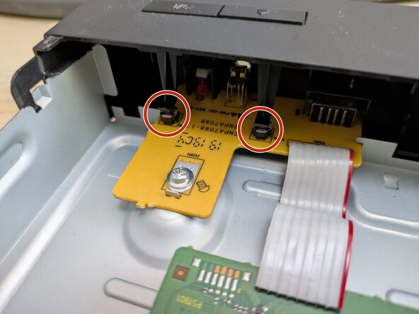

  16. Panasonic DP-UB150-K Laser Replacement, Refit case front: crwdns2935265:016crwdnd2935265:01crwdnd2935265:03crwdne2935265:0 Panasonic DP-UB150-K Laser Replacement, Refit case front: crwdns2935265:016crwdnd2935265:02crwdnd2935265:03crwdne2935265:0 Panasonic DP-UB150-K Laser Replacement, Refit case front: crwdns2935265:016crwdnd2935265:03crwdnd2935265:03crwdne2935265:0
    • Slide the case front over the open drive tray.
    • Make sure the button pushers are lined up with the switches on the orange board.
    • Clip the case front in place. Latches are on the left and right sides with two underneath.
