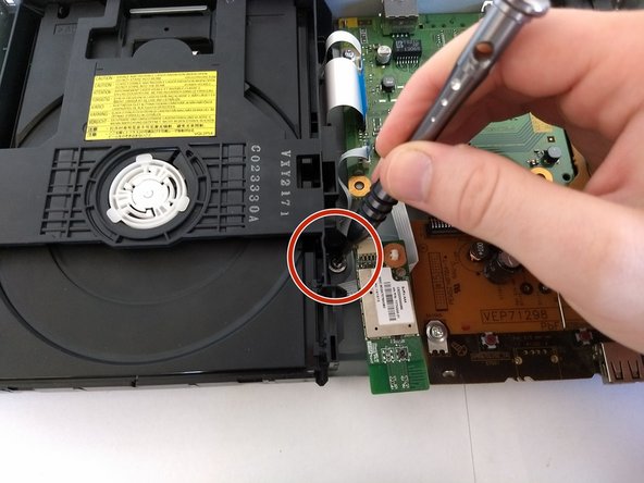

  8. Panasonic DMP-BD89 Disk Drive Replacement, Disk Drive: crwdns2935265:08crwdnd2935265:01crwdnd2935265:02crwdne2935265:0 Panasonic DMP-BD89 Disk Drive Replacement, Disk Drive: crwdns2935265:08crwdnd2935265:02crwdnd2935265:02crwdne2935265:0
    • Remove screws surrounding disk drive that attach it to outer cover.

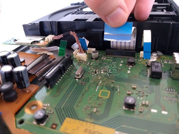

  9. Panasonic DMP-BD89 Disk Drive Replacement: crwdns2935265:09crwdnd2935265:01crwdnd2935265:02crwdne2935265:0 Panasonic DMP-BD89 Disk Drive Replacement: crwdns2935265:09crwdnd2935265:02crwdnd2935265:02crwdne2935265:0
    • Remove the one green andthree blue tabs pictured that connect the disk drive to the board. Try to do so carefully, to avoid damage to the hardware.
