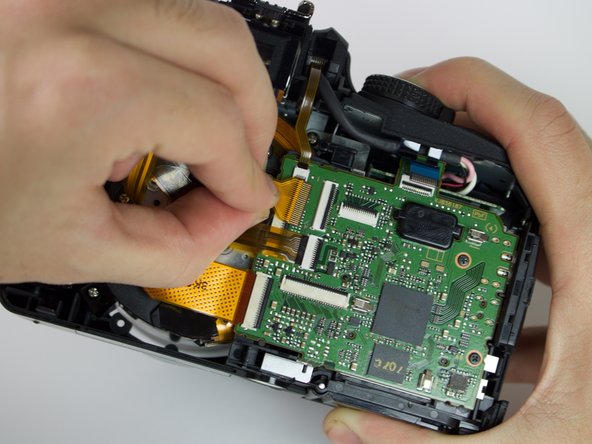

  7. Panasonic DMC-FZ70 Viewfinder Replacement: crwdns2935265:07crwdnd2935265:01crwdnd2935265:03crwdne2935265:0 Panasonic DMC-FZ70 Viewfinder Replacement: crwdns2935265:07crwdnd2935265:02crwdnd2935265:03crwdne2935265:0 Panasonic DMC-FZ70 Viewfinder Replacement: crwdns2935265:07crwdnd2935265:03crwdnd2935265:03crwdne2935265:0
    • Using a plastic opening tool, carefully flip up the small black levers that attach the ribbon cables to the ZIF connectors on the motherboard.
    • Carefully pull the ribbon cables out of the slot once they have been released.
    • Only the two indicated connectors need to be removed to separate the two halves of the camera.

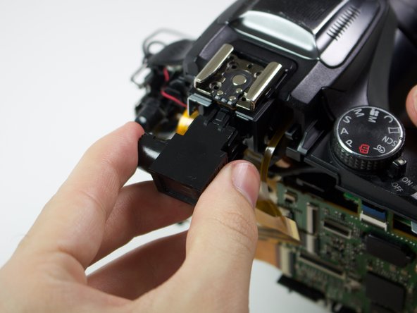

  8. Panasonic DMC-FZ70 Viewfinder Replacement, Viewfinder: crwdns2935265:08crwdnd2935265:01crwdnd2935265:02crwdne2935265:0 Panasonic DMC-FZ70 Viewfinder Replacement, Viewfinder: crwdns2935265:08crwdnd2935265:02crwdnd2935265:02crwdne2935265:0
    • Using a plastic opening tool, flip up the black switch on the ZIF connector that attaches the viewfinder to the motherboard.
    • Once the connector has been opened, gently pull the cable from its slot.
  9. Panasonic DMC-FZ70 Viewfinder Replacement: crwdns2935265:09crwdnd2935265:01crwdnd2935265:02crwdne2935265:0 Panasonic DMC-FZ70 Viewfinder Replacement: crwdns2935265:09crwdnd2935265:02crwdnd2935265:02crwdne2935265:0
    • Holding the sides of the viewfinder, pull it out of the camera.
    • Removing the viewfinder requires a strong, yet steady pull.
