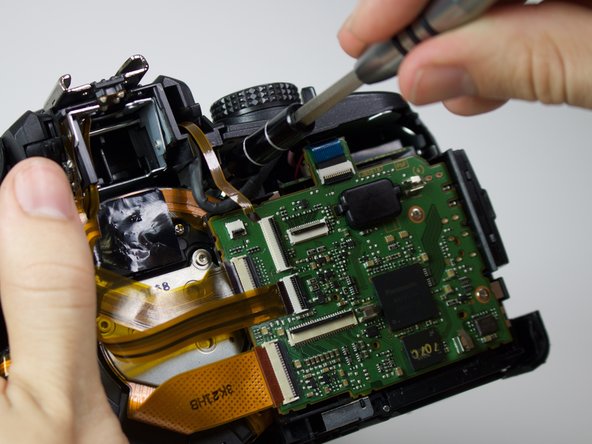

  8. Panasonic DMC-FZ70 Operation  Unit Replacement, Motherboard: crwdns2935265:08crwdnd2935265:01crwdnd2935265:01crwdne2935265:0
    • Using a Torx driver, unscrew the two 5mm Phillipd screws on the motherboard
  9. Panasonic DMC-FZ70 Operation  Unit Replacement: crwdns2935265:09crwdnd2935265:01crwdnd2935265:03crwdne2935265:0 Panasonic DMC-FZ70 Operation  Unit Replacement: crwdns2935265:09crwdnd2935265:02crwdnd2935265:03crwdne2935265:0 Panasonic DMC-FZ70 Operation  Unit Replacement: crwdns2935265:09crwdnd2935265:03crwdnd2935265:03crwdne2935265:0
    • The five ribbon cables shown will need to be removed from the ZIF connectors. Using a plastic opening tool, unlock the cables by lifting the black strip on the rectangular connection socket.
    • Carefully pull each of the ribbon cables out of their sockets.
    • The cable should slide out smoothly- any significant resistance might signal that the locking lever has not yet released the cable.

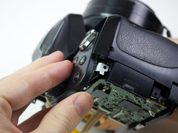

    • Once the screws and the ribbon cables have been removed, lift the mother board from its slot.
  11. Panasonic DMC-FZ70 Operation  Unit Replacement, Operation  Unit: crwdns2935265:011crwdnd2935265:01crwdnd2935265:02crwdne2935265:0 Panasonic DMC-FZ70 Operation  Unit Replacement, Operation  Unit: crwdns2935265:011crwdnd2935265:02crwdnd2935265:02crwdne2935265:0
    • Unscrew one 10mm Phillips screw to the right and underneath the viewfinder.
  12. Panasonic DMC-FZ70 Operation  Unit Replacement: crwdns2935265:012crwdnd2935265:01crwdnd2935265:01crwdne2935265:0
    • Using a plastic opening tool, flip up the switch on the ZIF connector underneath the operations unit and pull the ribbon out of the motherboard.
  13. Panasonic DMC-FZ70 Operation  Unit Replacement: crwdns2935265:013crwdnd2935265:01crwdnd2935265:03crwdne2935265:0 Panasonic DMC-FZ70 Operation  Unit Replacement: crwdns2935265:013crwdnd2935265:02crwdnd2935265:03crwdne2935265:0 Panasonic DMC-FZ70 Operation  Unit Replacement: crwdns2935265:013crwdnd2935265:03crwdnd2935265:03crwdne2935265:0
    • Slide out and replace the operation unit.
