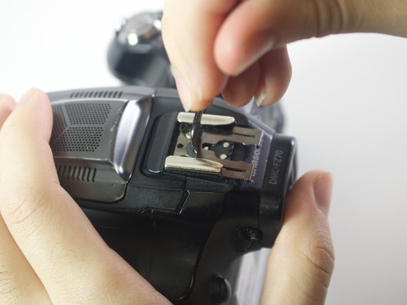

    • On the top of the camera locate the two rails with a thin sheet of metal on the floor between them.
    • With a metal spudger, lift this sheet and push it out of the rail device to detach it from the camera.
  5. Panasonic DMC-FZ70 Motherboard Replacement: crwdns2935265:05crwdnd2935265:01crwdnd2935265:01crwdne2935265:0
    • Proceed to remove the four 5mm Phillips screws that you just uncovered.
