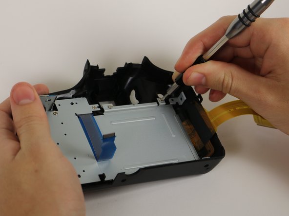

      • Unscrew the five 5mm screws on the panel that you just removed.
    2. Panasonic DMC-FZ70 LCD Screen Replacement: crwdns2935265:09crwdnd2935265:01crwdnd2935265:02crwdne2935265:0 Panasonic DMC-FZ70 LCD Screen Replacement: crwdns2935265:09crwdnd2935265:02crwdnd2935265:02crwdne2935265:0

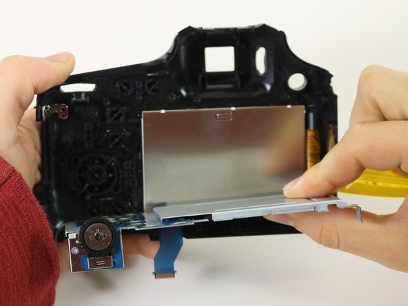

      • Remove the entire silver panel to reveal the back of the LCD screen
    3. Panasonic DMC-FZ70 LCD Screen Replacement: crwdns2935265:010crwdnd2935265:01crwdnd2935265:01crwdne2935265:0
      • Remove the LCD screen.
