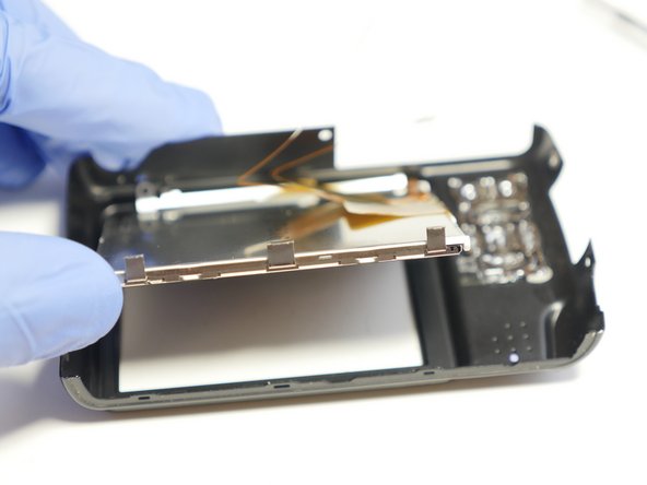

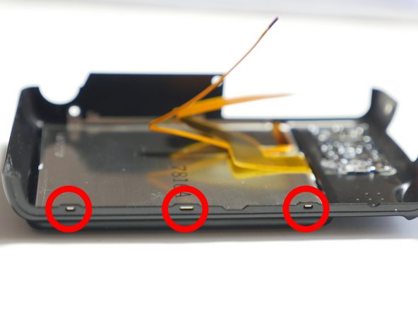

    9. Panasonic Camera DMC-TZ3 LCD DISPLAY Replacement: crwdns2935265:09crwdnd2935265:01crwdnd2935265:03crwdne2935265:0 Panasonic Camera DMC-TZ3 LCD DISPLAY Replacement: crwdns2935265:09crwdnd2935265:02crwdnd2935265:03crwdne2935265:0 Panasonic Camera DMC-TZ3 LCD DISPLAY Replacement: crwdns2935265:09crwdnd2935265:03crwdnd2935265:03crwdne2935265:0
      • Use a spudger or other tool to release the 3 clips between the LCD case and housing.
      • Note: when re-assembly all 3 clips need to be seated in the grooves as shown in the 2nd picture.
      • Lift LCD out as shown in 3rd picture
