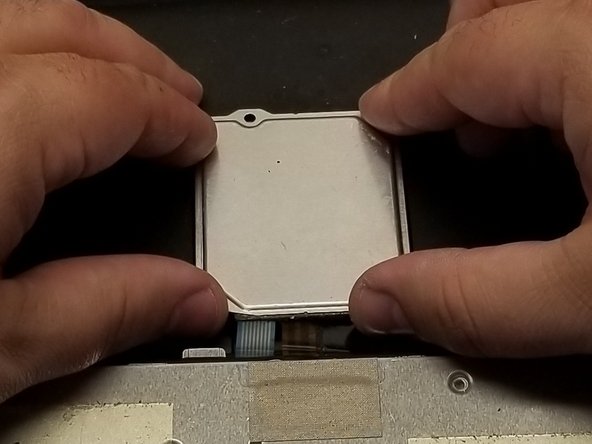

  4. Panasonic CF-31 Toughbook  Keyboard  Replacement: crwdns2935265:04crwdnd2935265:01crwdnd2935265:02crwdne2935265:0 Panasonic CF-31 Toughbook  Keyboard  Replacement: crwdns2935265:04crwdnd2935265:02crwdnd2935265:02crwdne2935265:0
    • Use a Phillips # 2 screwdriver to remove the four screws securing the keyboard shield.
    • Remove the keyboard shield.
