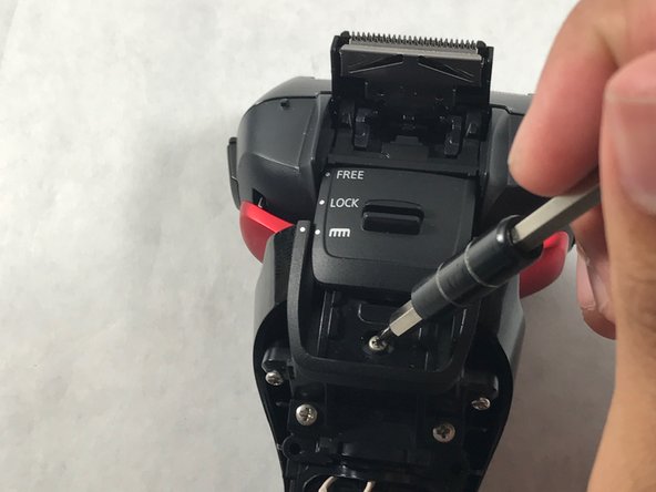

  8. Panasonic ARC ES-LT3N Power Button Replacement, Power Button: crwdns2935265:08crwdnd2935265:01crwdnd2935265:03crwdne2935265:0 Panasonic ARC ES-LT3N Power Button Replacement, Power Button: crwdns2935265:08crwdnd2935265:02crwdnd2935265:03crwdne2935265:0 Panasonic ARC ES-LT3N Power Button Replacement, Power Button: crwdns2935265:08crwdnd2935265:03crwdnd2935265:03crwdne2935265:0
    • Remove the 8 mm screws directly below the lock switch.

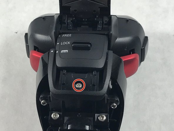

  9. Panasonic ARC ES-LT3N Power Button Replacement: crwdns2935265:09crwdnd2935265:01crwdnd2935265:03crwdne2935265:0 Panasonic ARC ES-LT3N Power Button Replacement: crwdns2935265:09crwdnd2935265:02crwdnd2935265:03crwdne2935265:0 Panasonic ARC ES-LT3N Power Button Replacement: crwdns2935265:09crwdnd2935265:03crwdnd2935265:03crwdne2935265:0
    • Push the lock switch upward and remove the 6 mm screw hidden beneath.
