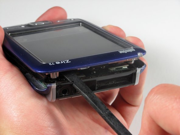

  6. PalmOne Zire 72 Screen Replacement: crwdns2935265:06crwdnd2935265:01crwdnd2935265:02crwdne2935265:0 PalmOne Zire 72 Screen Replacement: crwdns2935265:06crwdnd2935265:02crwdnd2935265:02crwdne2935265:0
    • Spin the phone around so that the headphone jack is facing you. Run the flat end of the spudger around the entire edge of the device to gently pry the case off.
    • Gently remove the case to avoid damaging it. Do not try to force the case open.
    • The L shaped latches located on the bottom of the device make it hard to remove the case; you should run the spudger around the device's edges again if you are having problems.

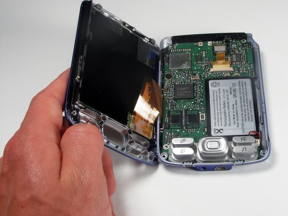

  7. PalmOne Zire 72 Screen Replacement: crwdns2935265:07crwdnd2935265:01crwdnd2935265:02crwdne2935265:0 PalmOne Zire 72 Screen Replacement: crwdns2935265:07crwdnd2935265:02crwdnd2935265:02crwdne2935265:0
    • Remove the cover by lifting it from right to left.
    • This should be similar to the action of the opening of a book.
    • The brown film connecting the motherboard to the screen may tear if this is not done correctly.

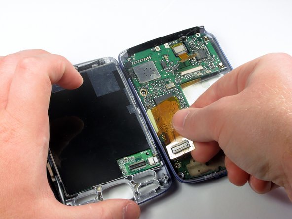

  12. PalmOne Zire 72 Screen Replacement: crwdns2935265:012crwdnd2935265:01crwdnd2935265:02crwdne2935265:0 PalmOne Zire 72 Screen Replacement: crwdns2935265:012crwdnd2935265:02crwdnd2935265:02crwdne2935265:0
    • Disconnect the orange video connector leading from the lower case to the upper case with the pointed end of the spudger.
    • The orange video connector is the cable that connects the motherboard to the screen.

  15. PalmOne Zire 72 Screen Replacement: crwdns2935265:015crwdnd2935265:01crwdnd2935265:02crwdne2935265:0 PalmOne Zire 72 Screen Replacement: crwdns2935265:015crwdnd2935265:02crwdnd2935265:02crwdne2935265:0
    • Lift screen from panel.
