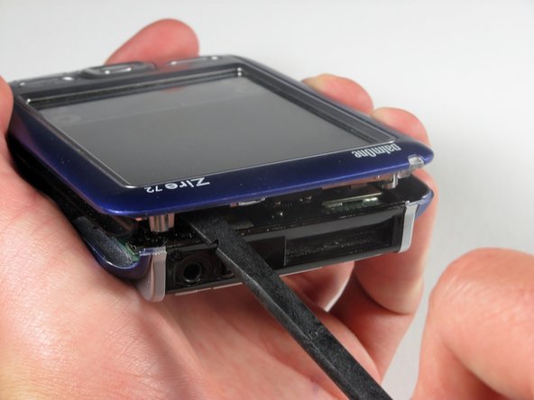

  6. PalmOne Zire 72 Control Pad Replacement: crwdns2935265:06crwdnd2935265:01crwdnd2935265:02crwdne2935265:0 PalmOne Zire 72 Control Pad Replacement: crwdns2935265:06crwdnd2935265:02crwdnd2935265:02crwdne2935265:0
    • Spin the phone around so that the headphone jack is facing you. Run the flat end of the spudger around the entire edge of the device to gently pry the case off.
    • Gently remove the case to avoid damaging it. Do not try to force the case open.
    • The L shaped latches located on the bottom of the device make it hard to remove the case; you should run the spudger around the device's edges again if you are having problems.

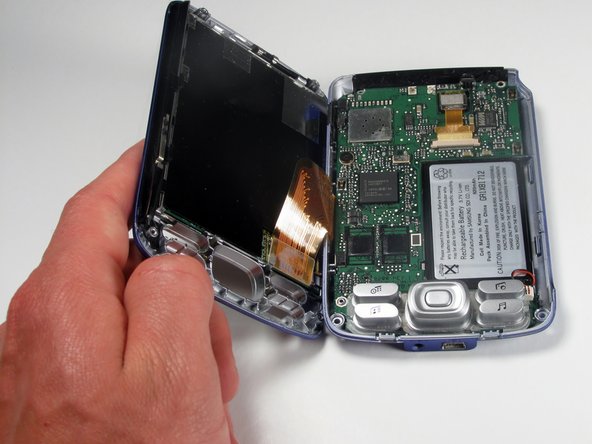

  7. PalmOne Zire 72 Control Pad Replacement: crwdns2935265:07crwdnd2935265:01crwdnd2935265:02crwdne2935265:0 PalmOne Zire 72 Control Pad Replacement: crwdns2935265:07crwdnd2935265:02crwdnd2935265:02crwdne2935265:0
    • Remove the cover by lifting it from right to left.
    • This should be similar to the action of the opening of a book.
    • The brown film connecting the motherboard to the screen may tear if this is not done carefully.
  8. PalmOne Zire 72 Control Pad Replacement: crwdns2935265:08crwdnd2935265:01crwdnd2935265:01crwdne2935265:0
    • Lift the control pad buttons off of the motherboard.
