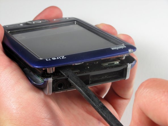

    • Spin the phone around so that the headphone jack is facing you. Run the flat end of the spudger around the entire edge of the device to gently pry the case off.
    • Gently remove the case to avoid damaging it.
    • The L shaped latches located on the bottom of the device make it hard to remove the case; you should run the spudger around the device's edges again if you are having problems.

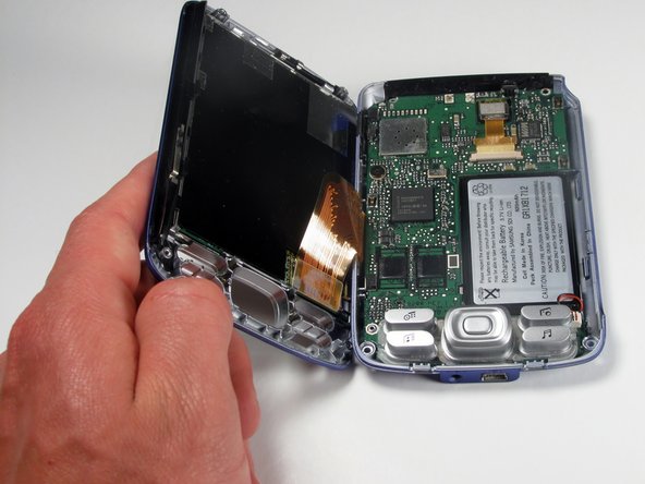

  7. PalmOne Zire 72 Camera Replacement: crwdns2935265:07crwdnd2935265:01crwdnd2935265:02crwdne2935265:0 PalmOne Zire 72 Camera Replacement: crwdns2935265:07crwdnd2935265:02crwdnd2935265:02crwdne2935265:0
    • Remove the cover by lifting it from right to left.
    • This should be similar to the action of the opening of a book.
    • The brown film connecting the motherboard to the screen may tear if this is not done carefully.

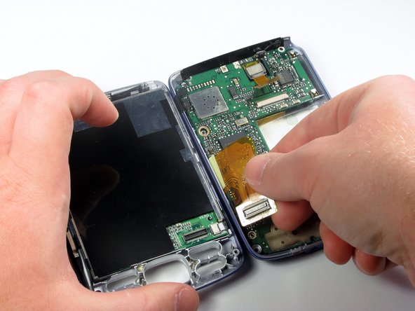

    • Unplug the orange video connector leading from the lower case to the upper case.
    • The orange video connector is the cable that connects the motherboard to the screen.

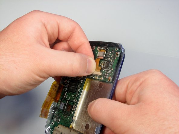

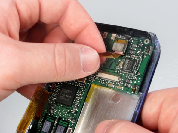

    • Disconnect the camera from the motherboard. There are 1.5mm gaps on either side of the connector between the connector and its port. Put the pointed end of the spudger in one gap at a time and "walk" the connector out by wedging out the connector on each side.
    • If it is difficult to pry out the connector completely with the spudger, you may remove it by hand.

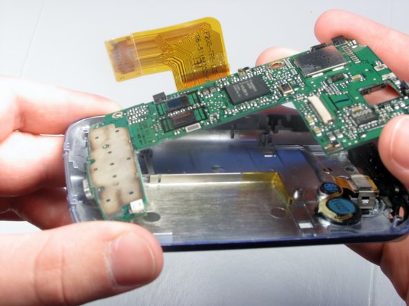

  15. PalmOne Zire 72 Camera Replacement: crwdns2935265:015crwdnd2935265:01crwdnd2935265:02crwdne2935265:0 PalmOne Zire 72 Camera Replacement: crwdns2935265:015crwdnd2935265:02crwdnd2935265:02crwdne2935265:0
    • Feed the video connector from the camera through the square hole in the motherboard.
    • After doing so, you may carefully lift the motherboard out of the back case.
