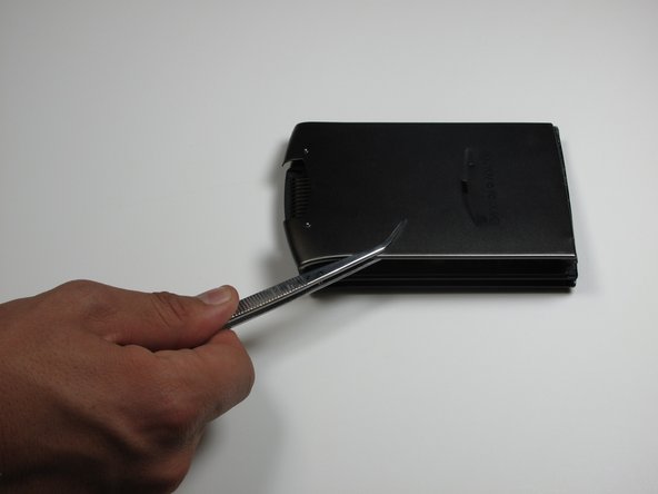

  3. Palm v Logic Board Replacement: crwdns2935265:03crwdnd2935265:01crwdnd2935265:01crwdne2935265:0
    • Use tweezers to hold Palm right side down on it's side.
    • Use a plastic opening tool to pry open front and back casing.
    • If you are unable to open you may need to heat with hairdryer for longer.
    • Be sure not to touch case directly with fingers, it will be hot!
  4. Palm v Logic Board Replacement: crwdns2935265:04crwdnd2935265:01crwdnd2935265:01crwdne2935265:0
    • Leave plastic opening tools in between front and back casing.
    • Rotate Palm and repeat steps 2 and 3 for right and back edges.

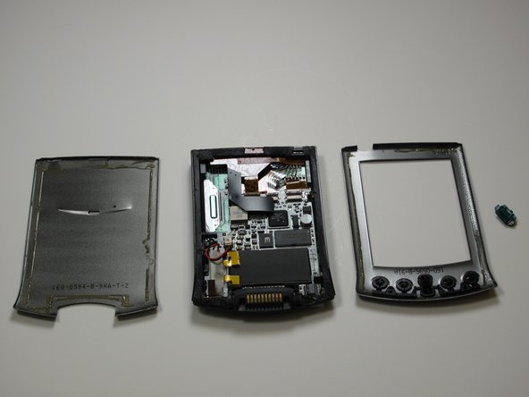

  5. Palm v Logic Board Replacement: crwdns2935265:05crwdnd2935265:01crwdnd2935265:03crwdne2935265:0 Palm v Logic Board Replacement: crwdns2935265:05crwdnd2935265:02crwdnd2935265:03crwdne2935265:0 Palm v Logic Board Replacement: crwdns2935265:05crwdnd2935265:03crwdnd2935265:03crwdne2935265:0
    • Now pry open front and back casing with plastic opening tools.
    • Separate front and back casing completely.
    • Power button will fall off once front and back casing have been removed. Be sure not to lose it.

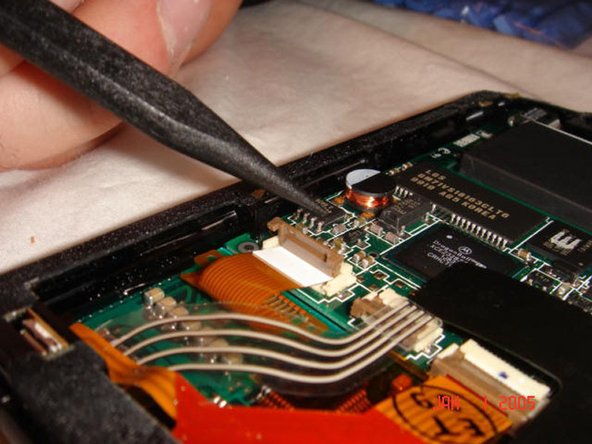

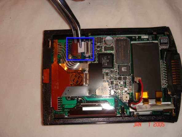

  6. Palm v Logic Board Replacement, Screen: crwdns2935265:06crwdnd2935265:01crwdnd2935265:02crwdne2935265:0 Palm v Logic Board Replacement, Screen: crwdns2935265:06crwdnd2935265:02crwdnd2935265:02crwdne2935265:0
    • In order to seperate the screen from the motherboard you must disconnect the ribbon attached to the screen.
    • To do this, using tweezers, flip up the cable clamp that is connecting the ribbon to the screen.
    • Once the clamp is up you can use the tweezers to gently detach the ribbon.

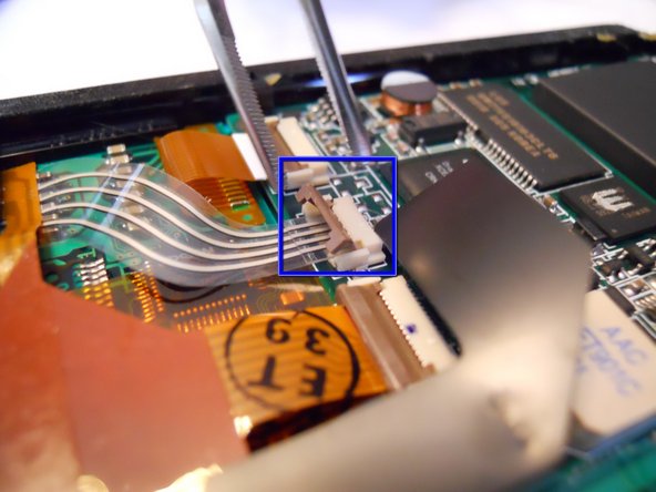

  7. Palm v Logic Board Replacement: crwdns2935265:07crwdnd2935265:01crwdnd2935265:03crwdne2935265:0 Palm v Logic Board Replacement: crwdns2935265:07crwdnd2935265:02crwdnd2935265:03crwdne2935265:0 Palm v Logic Board Replacement: crwdns2935265:07crwdnd2935265:03crwdnd2935265:03crwdne2935265:0
    • Now you must flip up the adjacent clamp as well, using tweezers like before.
    • After the clamp is flipped you can gently remove the second ribbon with tweezers.
