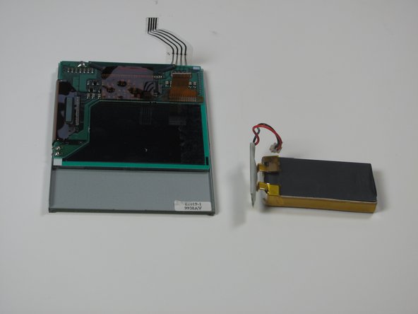

  9. Palm v Battery Replacement: crwdns2935265:09crwdnd2935265:01crwdnd2935265:01crwdne2935265:0
    • Now that both ribbons and the wire are disconeccted, you can apply a downward pressure to the battery. You will have to carefully rotate the frame so that the battery can go through.

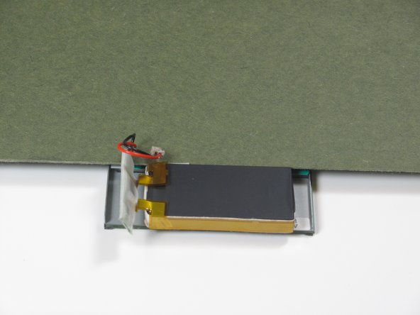

  10. Palm v Battery Replacement, Battery: crwdns2935265:010crwdnd2935265:01crwdnd2935265:02crwdne2935265:0 Palm v Battery Replacement, Battery: crwdns2935265:010crwdnd2935265:02crwdnd2935265:02crwdne2935265:0
    • Lay screen face down so the battery is facing upwards.
    • Cover the upper back portion of the device so the battery is the only exposed part.
  11. Palm v Battery Replacement: crwdns2935265:011crwdnd2935265:01crwdnd2935265:01crwdne2935265:0
    • Use the hairdryer to heat each side of the battery for at least 30 seconds.
  12. Palm v Battery Replacement: crwdns2935265:012crwdnd2935265:01crwdnd2935265:02crwdne2935265:0 Palm v Battery Replacement: crwdns2935265:012crwdnd2935265:02crwdnd2935265:02crwdne2935265:0
    • Using the tweezers or the spudger, pry off the battery from the screen.
    • If battery is not coming off, reheat sides and reattempt to remove.
