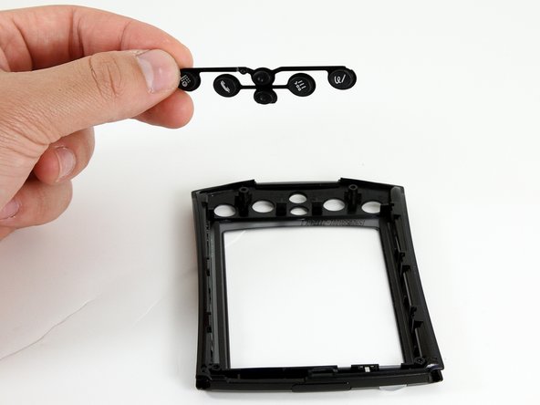

  7. Palm m500 button cover replacement, button covers: crwdns2935265:07crwdnd2935265:01crwdnd2935265:02crwdne2935265:0 Palm m500 button cover replacement, button covers: crwdns2935265:07crwdnd2935265:02crwdnd2935265:02crwdne2935265:0
    • Gently remove the buttons from the front panel with your thumb and forefinger.
    • The buttons are not secured and should easily fall out.
