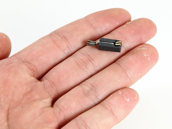

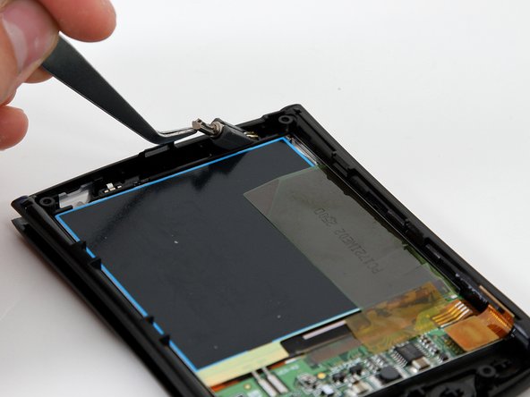

  6. Palm m500 Vibration Motor Replacement, Vibration Motor: crwdns2935265:06crwdnd2935265:01crwdnd2935265:03crwdne2935265:0 Palm m500 Vibration Motor Replacement, Vibration Motor: crwdns2935265:06crwdnd2935265:02crwdnd2935265:03crwdne2935265:0 Palm m500 Vibration Motor Replacement, Vibration Motor: crwdns2935265:06crwdnd2935265:03crwdnd2935265:03crwdne2935265:0
    • Use tweezers to gently pull the vibration motor away from the front panel.
    • The vibration motor is unsecured and should be easy to remove from the front panel.
