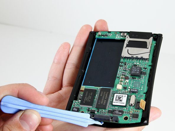

  4. Palm m500 LCD Screen Replacement, Battery: crwdns2935265:04crwdnd2935265:01crwdnd2935265:03crwdne2935265:0 Palm m500 LCD Screen Replacement, Battery: crwdns2935265:04crwdnd2935265:02crwdnd2935265:03crwdne2935265:0 Palm m500 LCD Screen Replacement, Battery: crwdns2935265:04crwdnd2935265:03crwdnd2935265:03crwdne2935265:0
    • Use tweezers to unplug the battery cable from the motherboard socket.
    • Gently remove the battery from the motherboard using your thumb and forefinger to pull upwards.
    • The battery may be difficult to remove because of light adhesive on the back. It may require some force to pry the battery away from the motherboard with your fingers.

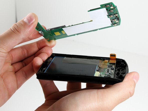

  5. Palm m500 LCD Screen Replacement, Motherboard: crwdns2935265:05crwdnd2935265:01crwdnd2935265:03crwdne2935265:0 Palm m500 LCD Screen Replacement, Motherboard: crwdns2935265:05crwdnd2935265:02crwdnd2935265:03crwdne2935265:0 Palm m500 LCD Screen Replacement, Motherboard: crwdns2935265:05crwdnd2935265:03crwdnd2935265:03crwdne2935265:0
    • Use the plastic opening tool to pry the orange clamp away from the motherboard.
    • Use the plastic opening tool at the bottom of the device to pry the motherboard away from the front plate.
    • Gently and forcefully lift the motherboard away from the front plate by using your thumb and forefinger.

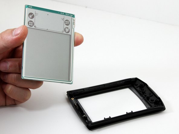

  6. Palm m500 LCD Screen Replacement, LCD Screen: crwdns2935265:06crwdnd2935265:01crwdnd2935265:02crwdne2935265:0 Palm m500 LCD Screen Replacement, LCD Screen: crwdns2935265:06crwdnd2935265:02crwdnd2935265:02crwdne2935265:0
    • Pull the LCD screen up from the bottom of the device using your forefinger.
    • The LCD screen will easily come away from the front panel.
